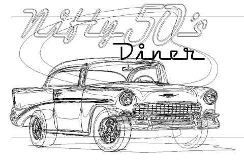

Are you working in spot colors or PMS Spec Colors?
If not, change them to spot colors. From there, you can simply use a tint of that spot color for highlights or gradations.
For example, a linear gradation can be built using 100% PMS 485 Red to 40% --- as shown on the sample piece below in the the side of the body. There are also oval and linear blends in the tires as well as a vector shape blend in the hood of the car.
It's all tints and blends of spot colors. This art was built with 4 spot colors, red, teal, yellow and black.
I find it easiest in Illustrator or CorelDraw, but it can be done in Photoshop Channels, too.
Hope that helps.

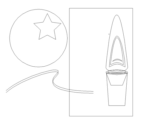

It's also an easy way for me to draw neon. I'll set the stroke/outline thickness to the size neon tube spec'd, 15mm, for example. Rounded ends and corners on the stroke, too. Then draw the neon image using a PMS (800s) fluorescent color.
Once I'm happy with the image,
I'll copy the stoke/outline and paste in front
Adjust the tint of the color to 30%
Set the stroke thickness to 4mm
blend the two strokes/outlines
Then throw a black box in the background to give the customer an idea of the look.
Once the drawing is approved, I'll convert the outlines to objects and paper plot the paths at actual size for the neon bender.

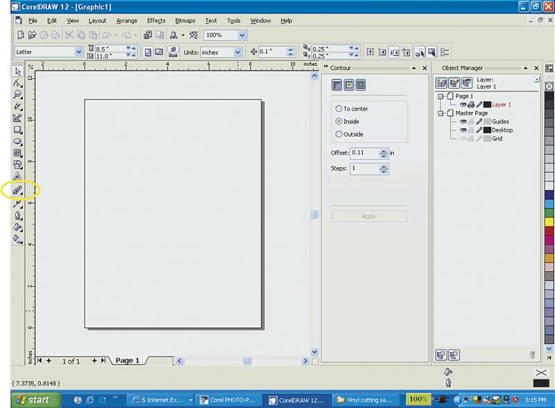

corel interactive blend tool
Here is the corel interactive blend tool.
