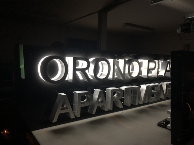

Well I just learned that this is a no go. Unfortunately the gloss acts as a mirror and the whole halo effect doesn't really happen and you see all the silicone, studs etc in the reflection.

Yeah, you need to use a diffuser vinyl on the background, almost any background. We have also used the frost vinyl on the substrate, works almost the same as diffuser.
Depending on your letter size etc, you can router cut matt clear polycarb or similar and mount that inside your letters to also diffuse
the leds. This method is a lot of work, but if you need to have the glossy background, this is a good way to resolve that. Good luck!

We use a lot of light diffusing white polycarbonate for halo letter backs. Still let’s enough light thru and the reflection does not show any of the module shadows like clear. Visibly looks better than clear with diffuser.
Jb1983
These letters have white poly carbonate letter backs, I don’t see any of the leds in the reflection just the studs/silicone and it’s more of a sharp edge rather than a halo.
I was planning on painting the backer panel flat black as it would be alot cheaper than vinyl wrap.
