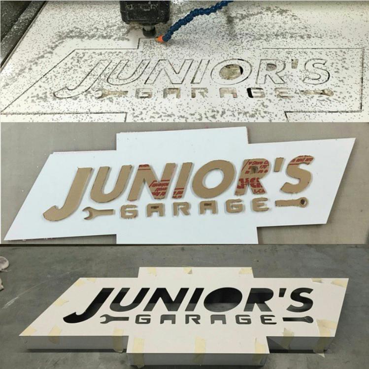

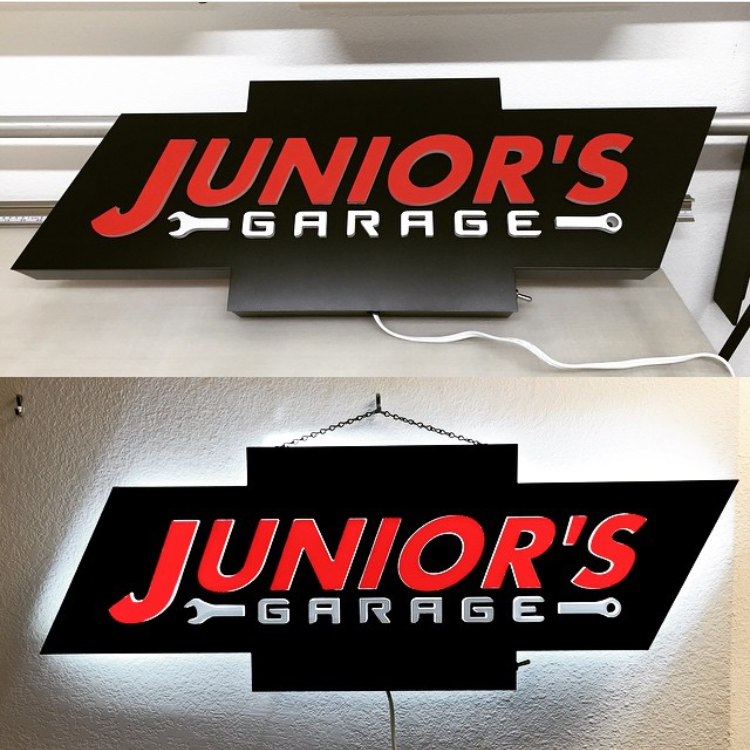

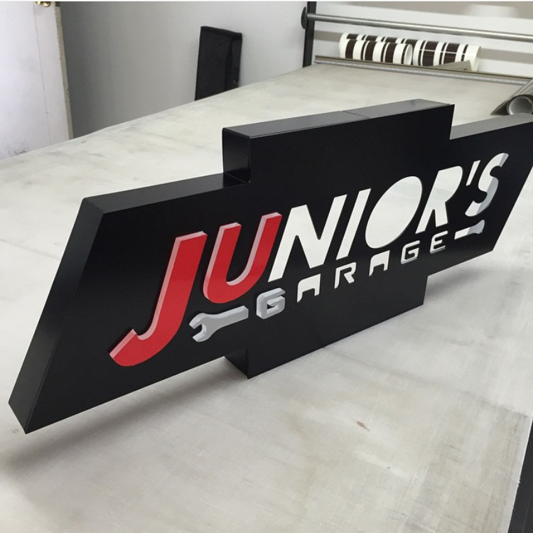

Did this halo-lit, push-thru Chevy sign for my nephew a few weeks back... just for fun and wanted to share it. :toasting:

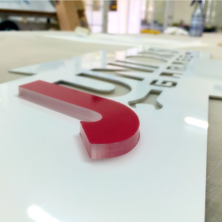

Nice work! I've always liked these types of signs, but i've never had the opportunity to make one. Just curious, how do you attach the letters in the back to keep them from falling through the box?
DirtyD
The letters are cnc routed out of acrylic but not all the way through - they leave a base at the bottom of the letter to attach to the inside of the sign - kind of like a countour
