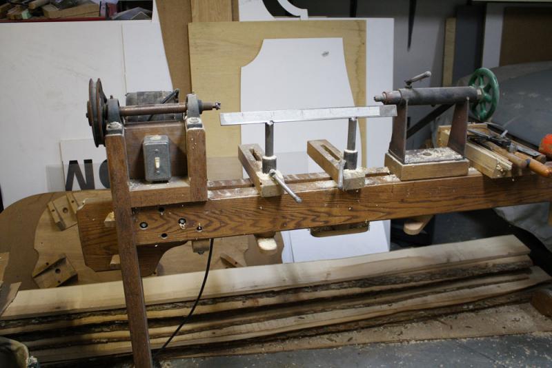

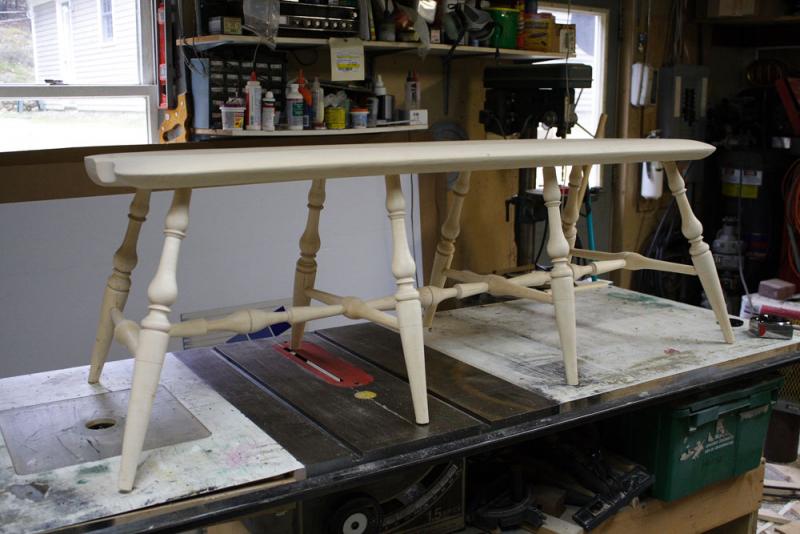

I haven't made one of these in at least 15 years. The whole task is done by hand. I use antique tools like an adze, a wooden spokeshave etc. Some of the tools were so obscure I had to make my own like my curved bladed spokeshave or Travisher. (I had to learn to forge tool blades)

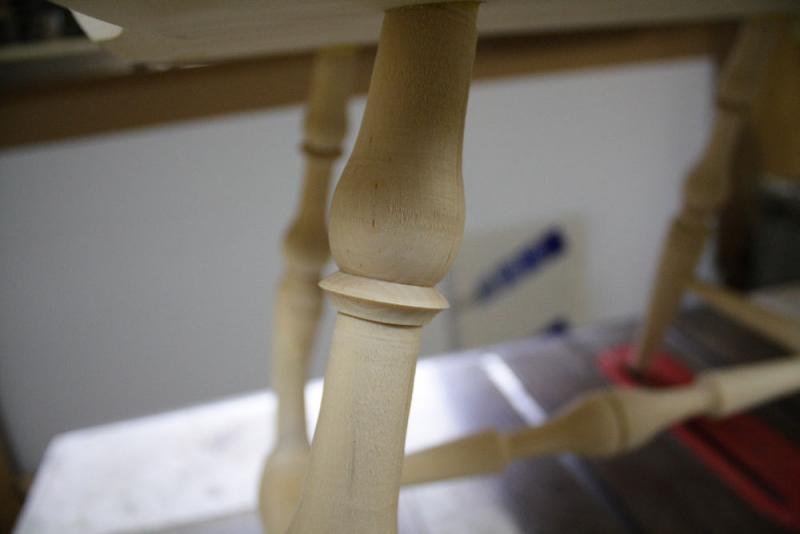

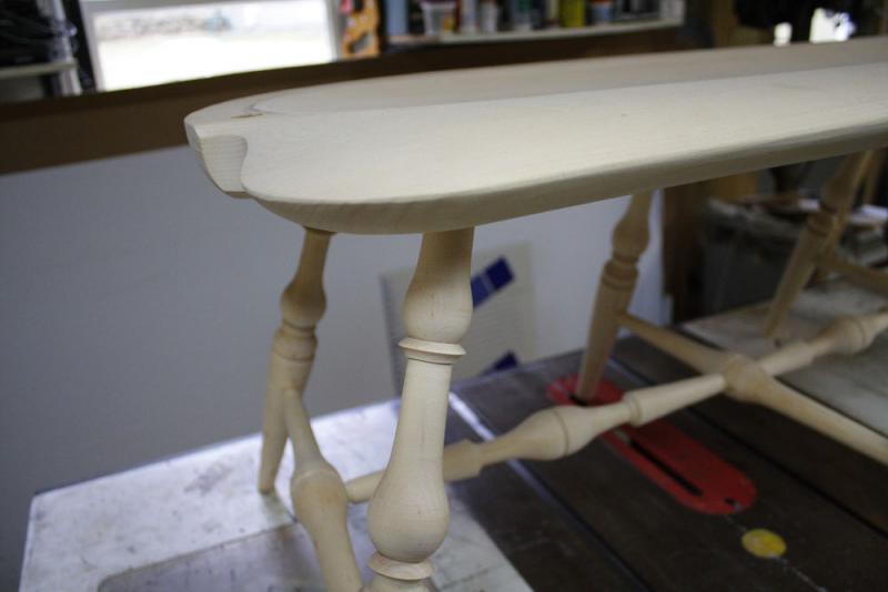

The seat was chopped out with an adze and then smoothed with the curved shave. The legs are turned by eye on the homemade wood lathe in the photo. All the turnings are left as they came off the lathe with no sanding. One of requirements of a proper reproduction windsor is the correct toolmarks on the various parts. The only thing sanded will be the seat surface....nothing else.

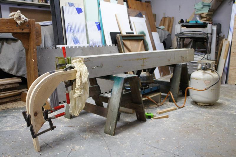

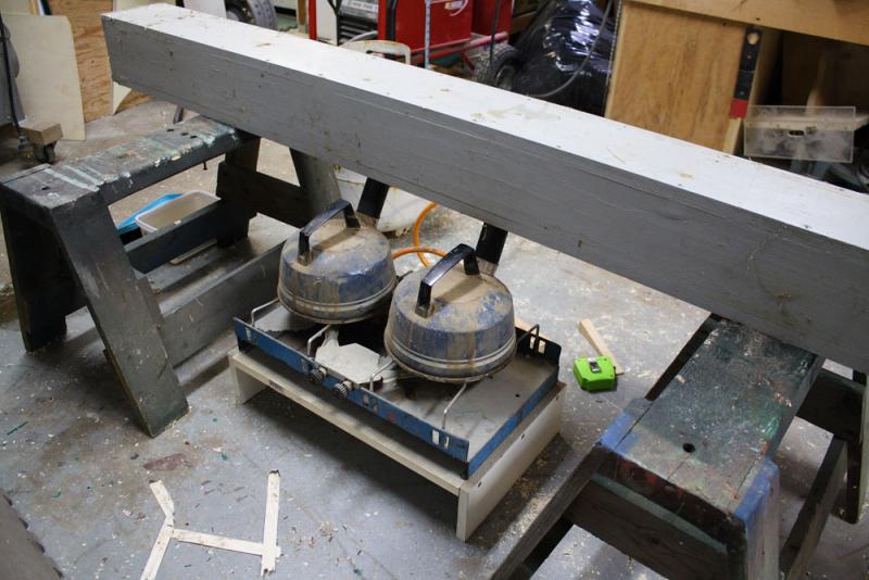

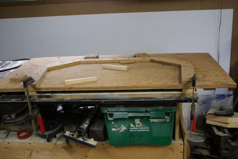

The arms and back bow are steam bent ash. The photo shows the second bend being steamed. My steambox is too short to fit the entire arm so I had to do one side at a time. I usually make two seat settees....this customer talked me into making a three seater. After the parts have steamed long enough they are quickly bent over a wooden bending form clamped to my tablesaw.
The next step is to shape and attach the arm bows and shave all the back spindles. I'll post a few more pics as I go along. I have to let the steamed parts dry for a few more days though. Steam bent parts are generally made from "green" wood so they have to be held in the proper shape until the wood has cured to right moisture content.

Forgot to post a pic of my sophisticated steambox setup.

Patrick I turned the legs myself. I built the lathe then learned to use it. When I'm going good I can knock out one of those legs in 15 minutes.....over and over again. I taught myself to turn by shearing so the wood is smooth without sanding. Because the legs are so thin in the middle I have to hold the spinning part with my left hand to damp vibration and use my right to hold and control the chisel. I wear a cotton glove to prevent friction burns.

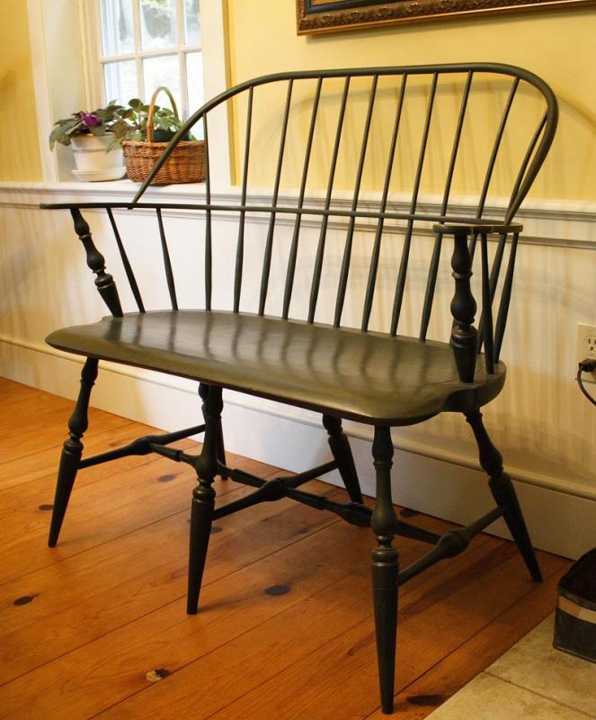

Here's one I built a while back. It's a 2 seater.

Ahhh.... the lathe. Very high tech. You adjust the toolrest with a mallet.
The lathe is designed to knock down for easy transport and storage. You knock out the wedges at each end then remove 1 bolt and it all comes apart. I have a longer bed for longer parts.
I have a friend who is a professional turner and he shakes his head whenever he sees my old lathe. He can't fathom how I can make anything with it. He has a monstrous cast iron industrial machine. It makes his knees weak when I grab ahold of the spinning part to steady it.

I got two 8 foot logs for 20 bucks. Then I had a guy with a bandsaw mill slice them up for me. The Ash is seasoned until the water in it is no longer visible when you cut a board in half. It's at about 22% moisture content when it is perfect for bending. If it gets too dry it breaks during the bend...too wet and it won't hold a reliable shape.
