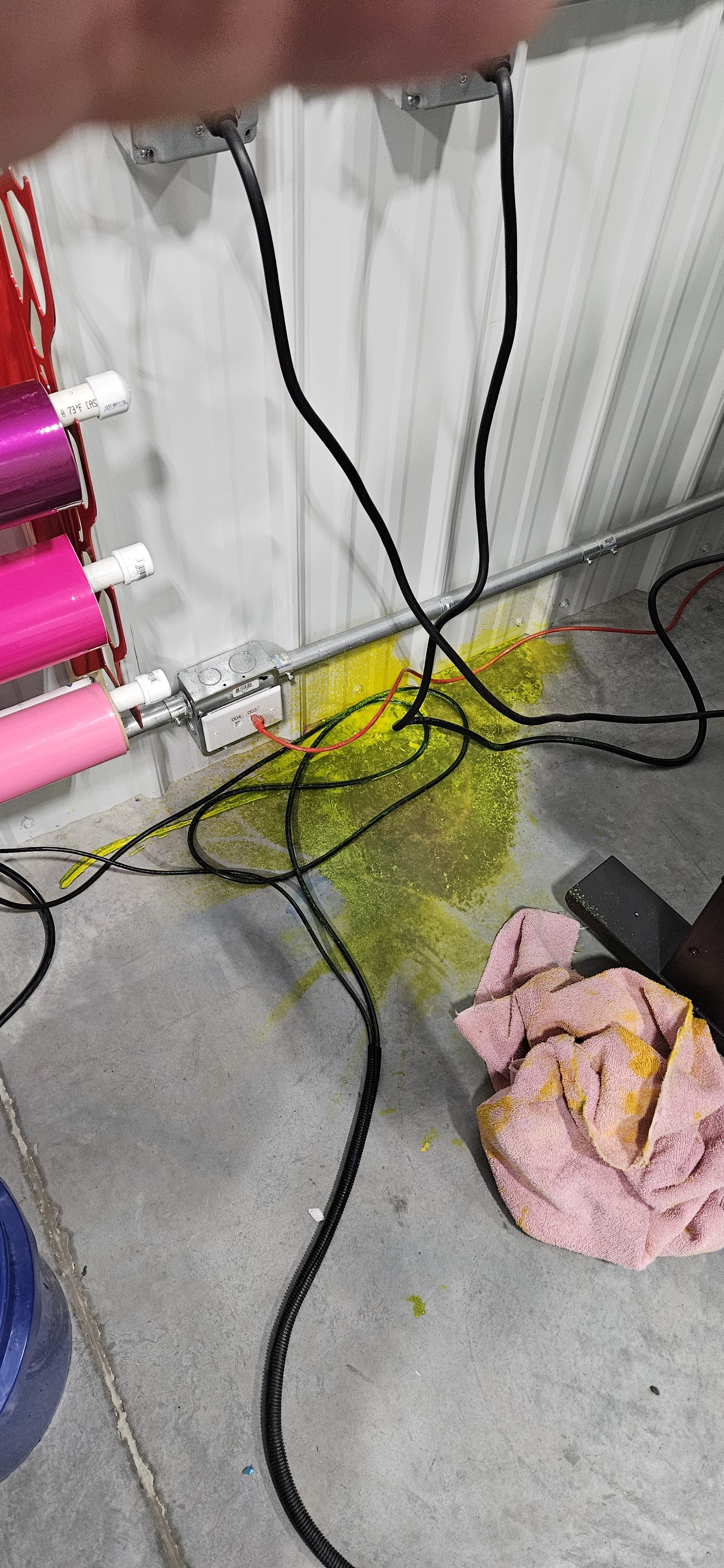

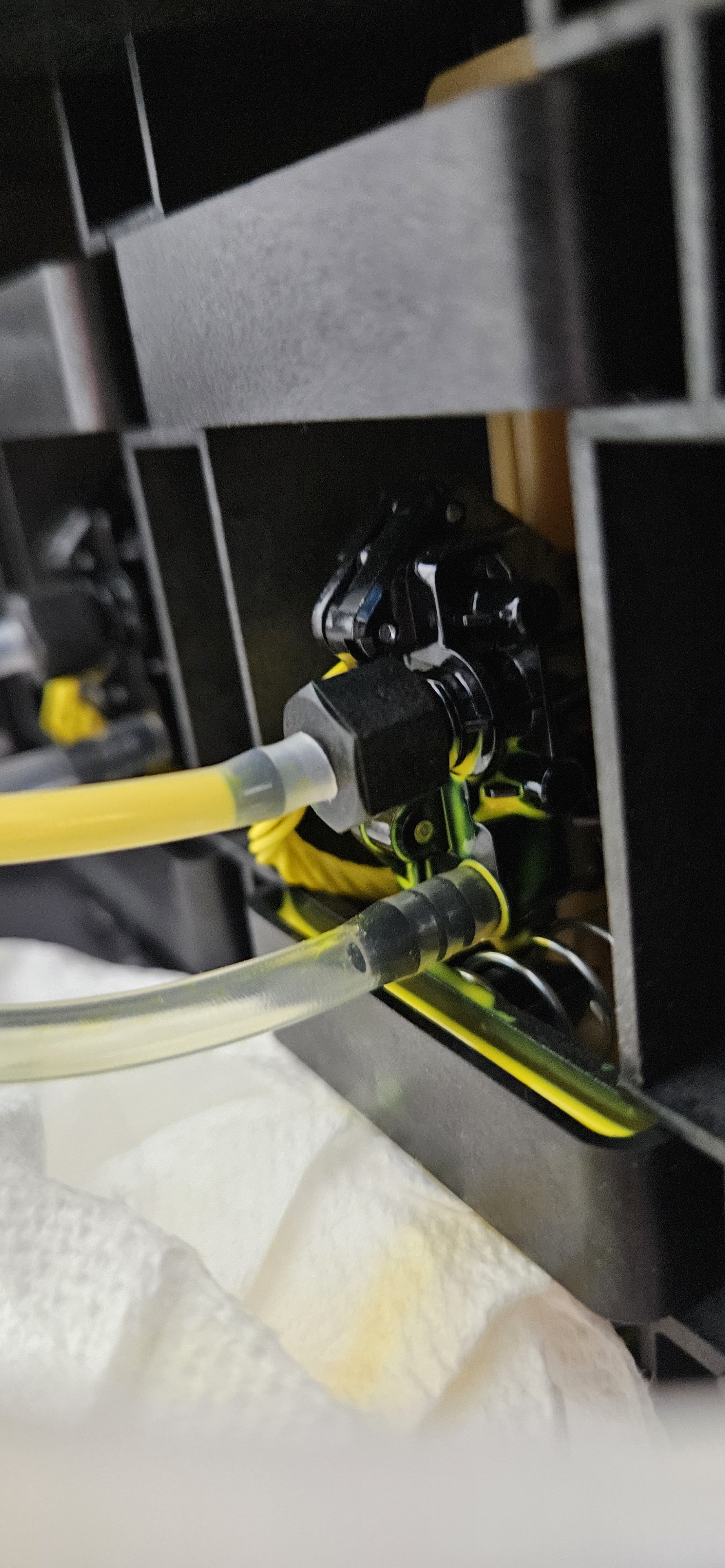

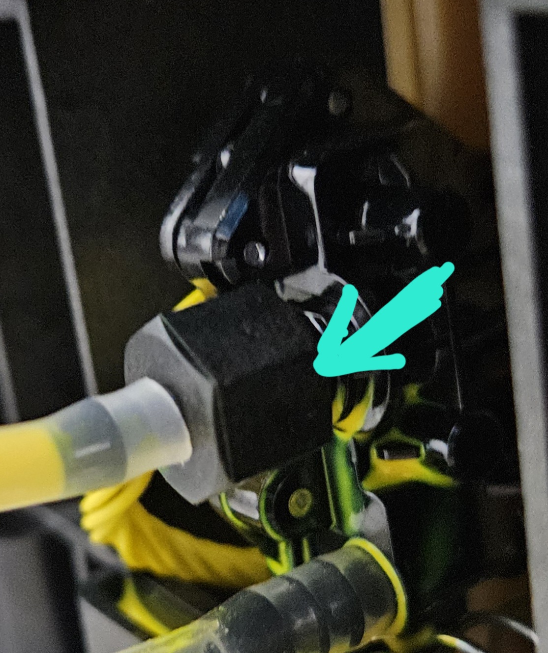

Need Help Has anyone else had this issue? hp335 Leaking right where the nut connects.
Vinyl Monkeys
Did this right before the warranty expired. Hp fixed 3 separate times each time it was a different color. Finally the last time the replace all the guts. 6 mos. later it started doing it again. I cannot find anything on this issue and both techs have never ran across this issue on a new machine. machine is only 18 mos. old. Is this what I will be expecting?

Could be a bad batch of Luer connectors... or the plastic of the PIPs is more brittle... I also never encountered it multiple times on the same unit in such a short time.

Thanks for the part definition. Both techs that came out told me what it was as we can see clearly. One tech also said he has never seen this on a newer machine, only like on old ones. I'm thinking it has to do with the pressure regulator cause there are times when I am changing cartridges mode and the pressure sounds like air brakes being released. I felt it used to not be that loud. and there are no error codes showing on my machine. I though maybe, I hope HP will honor some way. I cannot afford to have a tech come fix every 6 mos. Might have to buy an Epson. What a waist of $13k

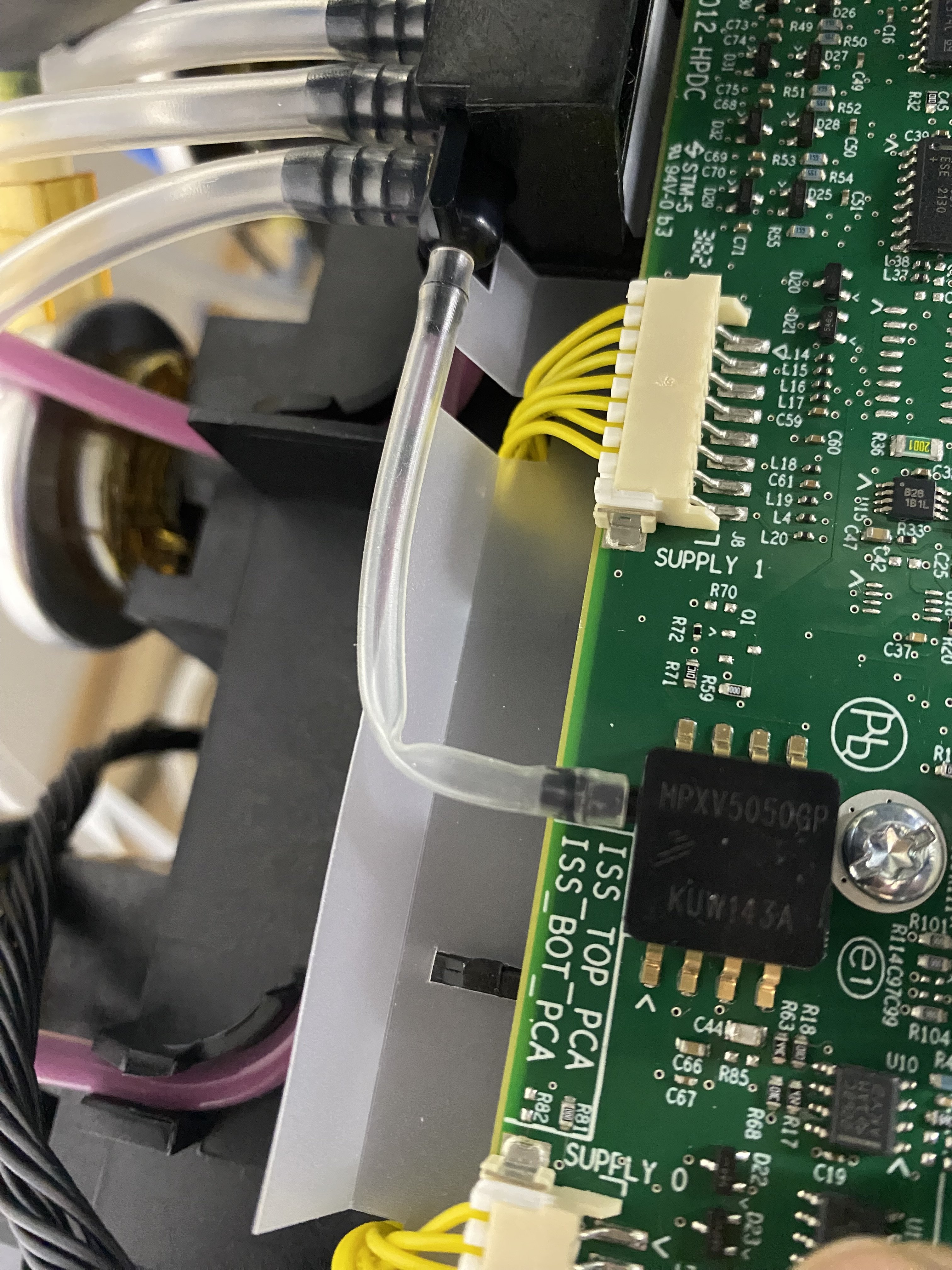

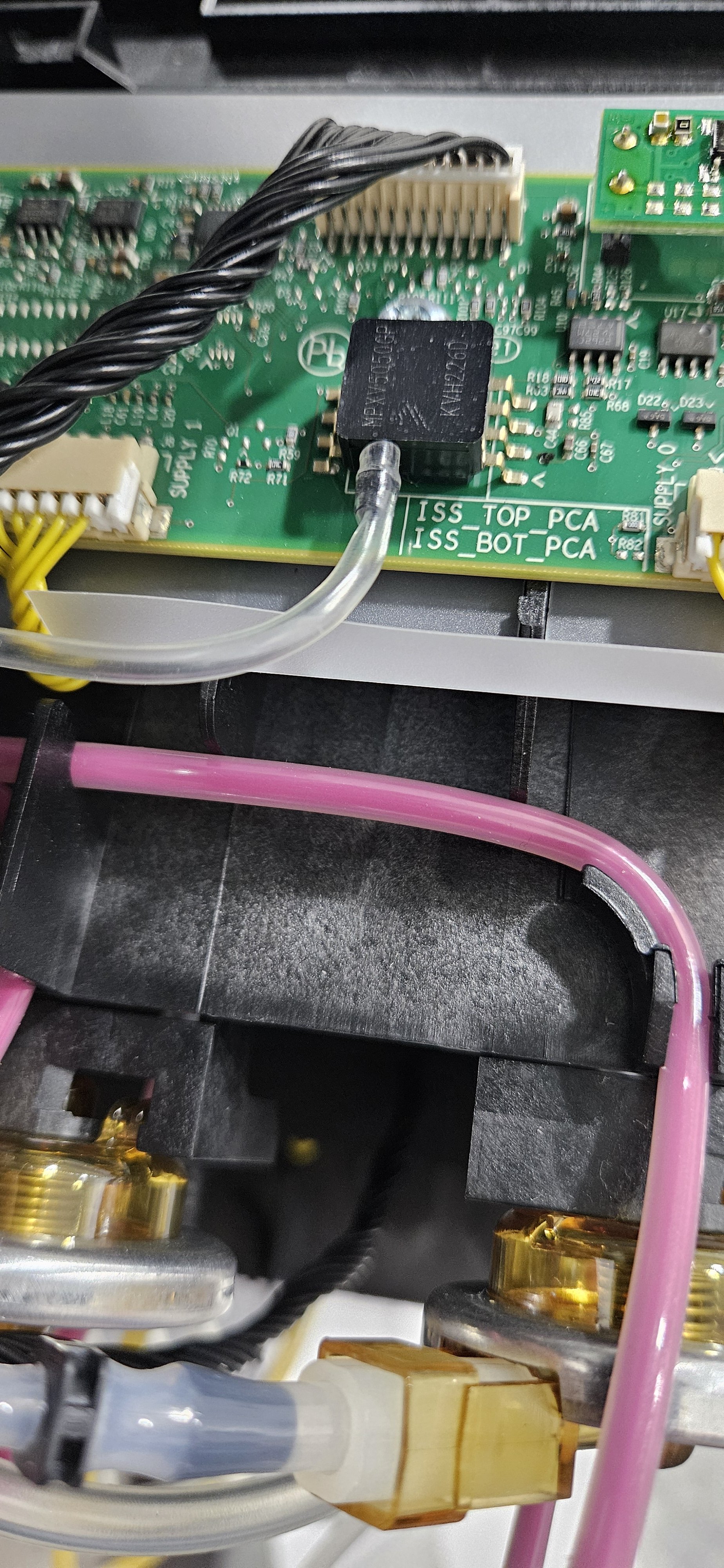

Check the tiny tube to pressure sensor on upper iss pca. Sometimes it is slightly kinked. Seen frequently, but never caused your issue to my experience.

Looks ok. A little at the nipple but this hose is like very flexible and not hard at all
