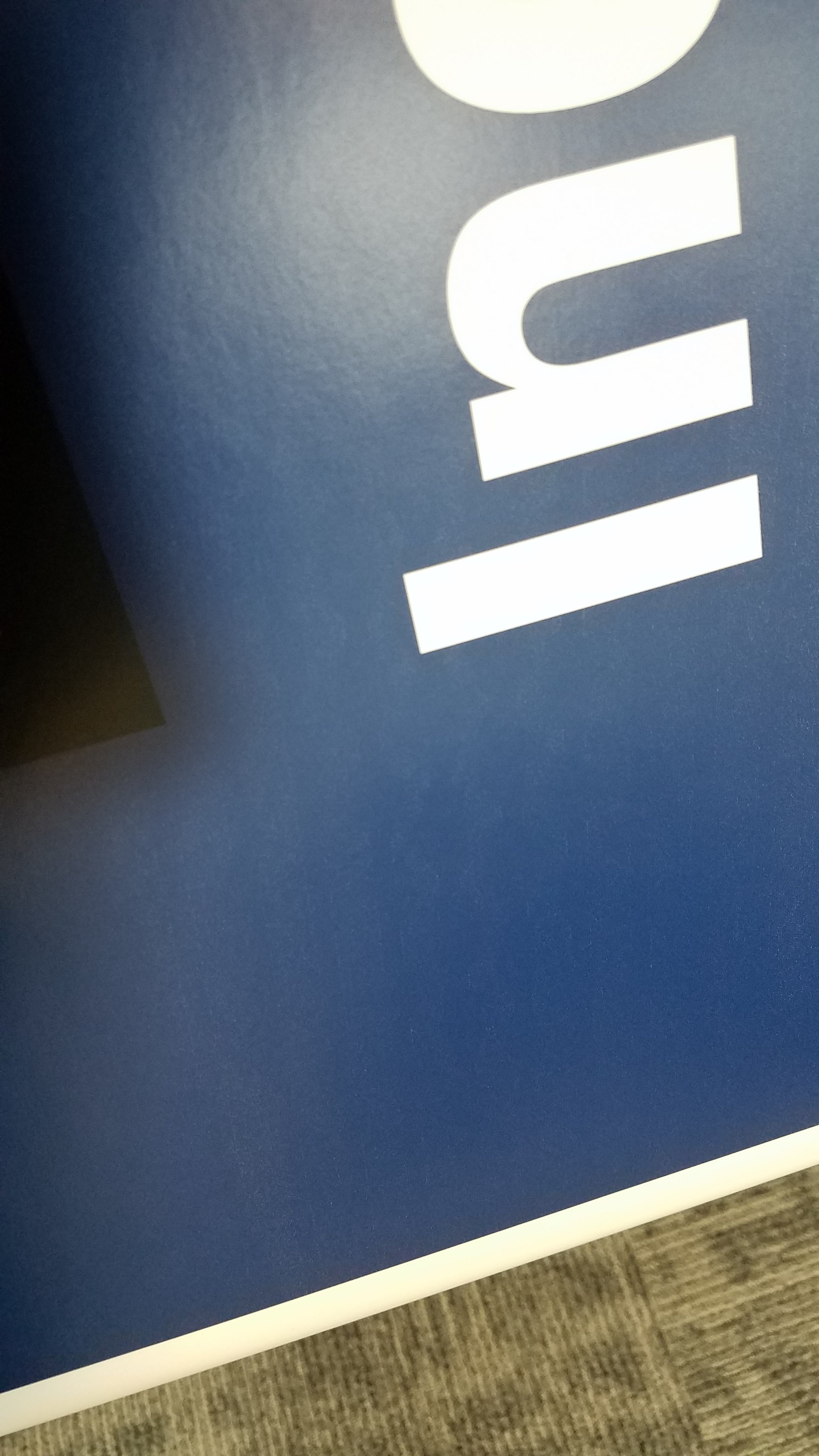

Has anyone seen this before?
ktwigger
Hi guys, needing some assistance here. This is the first time we've had this issue but there's wavy areas appearing on our translucent print. We've even printed a similar sign for the same company (only difference was the size) with the same material and settings and had no issue so I'm not sure why this is happening. Any advice would be very much appreciated. Printing on a HP Latex 560 on Avery Translucent MP2050. Sorry for the crappy pic, it was the best I could get with the glare.

My guess is plasticizer once again....
You can test that by cleaning an area with IPA and then print on it. If it's good, you have to change the roll to another.
Just tried it and it looks like you are correct. Thank you! Sucks that I have to buy a new roll...
Your supplier should replace it with a new one if it's not too old...
If it's like a month old it's considered defect.
