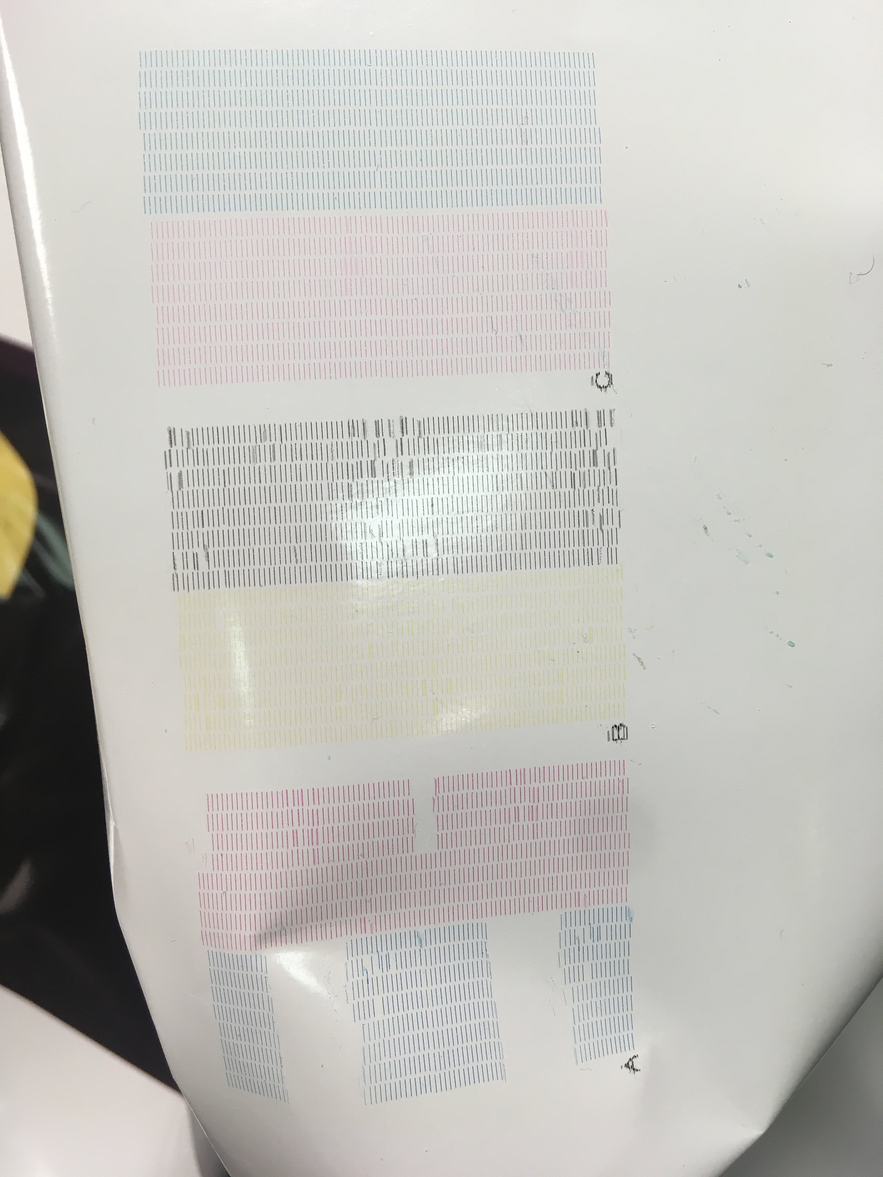

Ok so when conducting a test print my dark cyan A bank showed missing nossles in the center of the print. It was causing poor printing so I did some normal cleanings and the clogs seem pretty stubborn. So I did a powerful wash and jut wasted all my ink and still no improvements.Next I tried a head soak overnight with solution it actually made the cyan blue ink totally clogged! So looks like it made it worse. Now that Im in a terrible place with a completely clogged print head Im thinking about doing a manual flush using my manual to navigate into the tubings and flush the line. Has anyone done this before? or have a video to link me to? I do not have the funds to call a service tech.

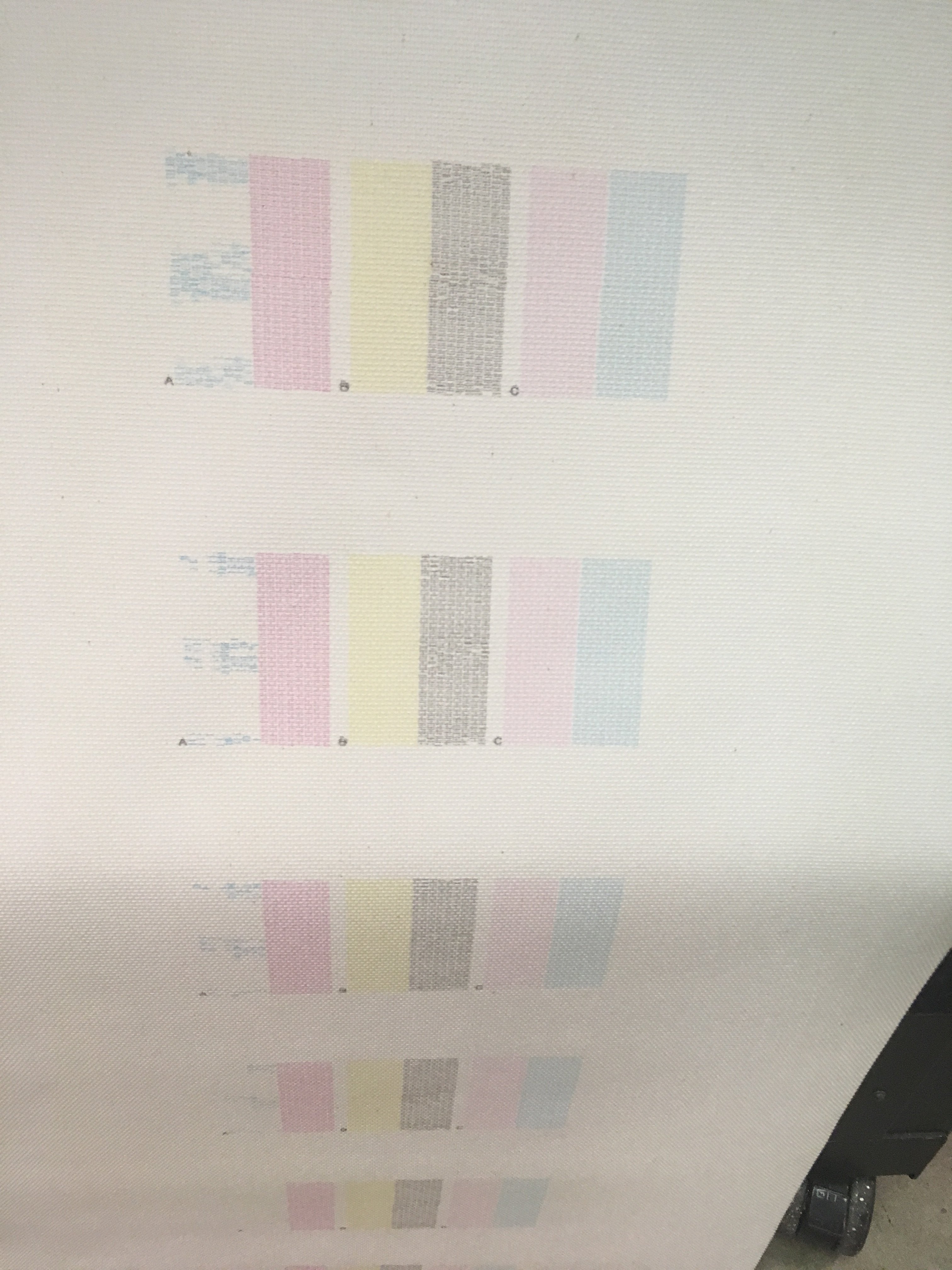

That must be the problem in terms of trying to get all that solution to clear out. I ended up worse then when I started! Image 1138 is where I started and began soaking the printhead overnight. Image 3648 is where I am today... as I continue cleaning it is not getting better. I think I should try a head flush using a syringe and tubing... have you done that before?

NCTech
What is the condition of your cap tops? Roland recommends annual replacement. The pumps can only prime the heads if the caps make a good seal to the nozzle plate.
Physically check for ink in your cartridges. (Pull out and tilt back and forward).
Remove the pump cover... disconnect the captop lines from pump 1 and use a syringe to draw about 5-10cc of ink. (Pull slowly and evenly). If no resistance is felt replace your caps. (Roland P/N 1000004546).
E Coloney
Looks like a classic cap top problem. Change cap tops and springs. Use the genuine Roland cap tops, not the knock-offs. Yeah, the knock-offs are MUCH cheaper but look at all the trouble they can be.
