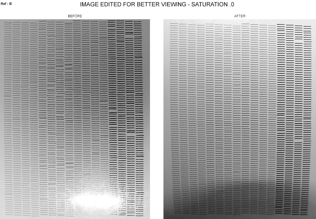

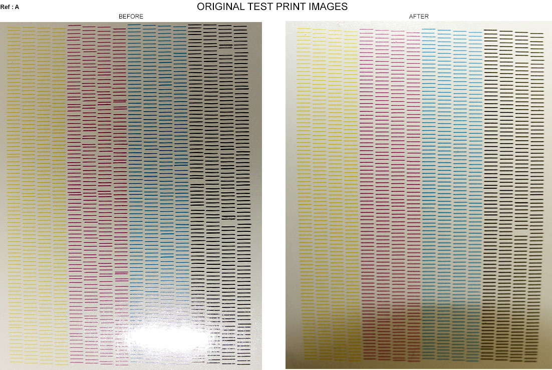

Attached are 3 image sets, all derived from the original - Ref : A
'BEFORE':
This presents the final and ongoing result following several clean cycles, manual cleanings, and an overnight head soak with regular cleaning fluid.
'AFTER':
This presents the final and consistent outcome following three manual swab cleanings with Acetone, which were immediately followed with cleaning fluid.
Ref -B:
To see better, I removed the color from the image.
Ref - C:
This was simply a color inversion of 'A' and/as just another option to see more clearly, particularly the hard to see Yellow.
Black mark (bottom) was hot-spot from camera flash.
Diagnosis:
Stubborn/hard to clean - clogging.
Procedure:
I first tested the foam head to be sure it wouldn't be compromised upon the introduction of Acetone.
Once established, I loaded up the foam head to full capacity, both sides.
Then with gentle scrubbing back to front & ...., left to right &....; also some circular motions across the face of each, and inverting the foam head as each were scrubbed a few times with one predesignated side of the foam.
*gentle
Conclusion:
It is my finding that this treatment became the solution for my DX4 heads, whereas regular head cleaning method was insufficient in achieving the desired results.
