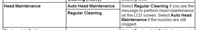

SignMeUpGraphics
Super Active Member
Wasn't even aware of this function... it's in the manual and exists on the menu of our 80600:
