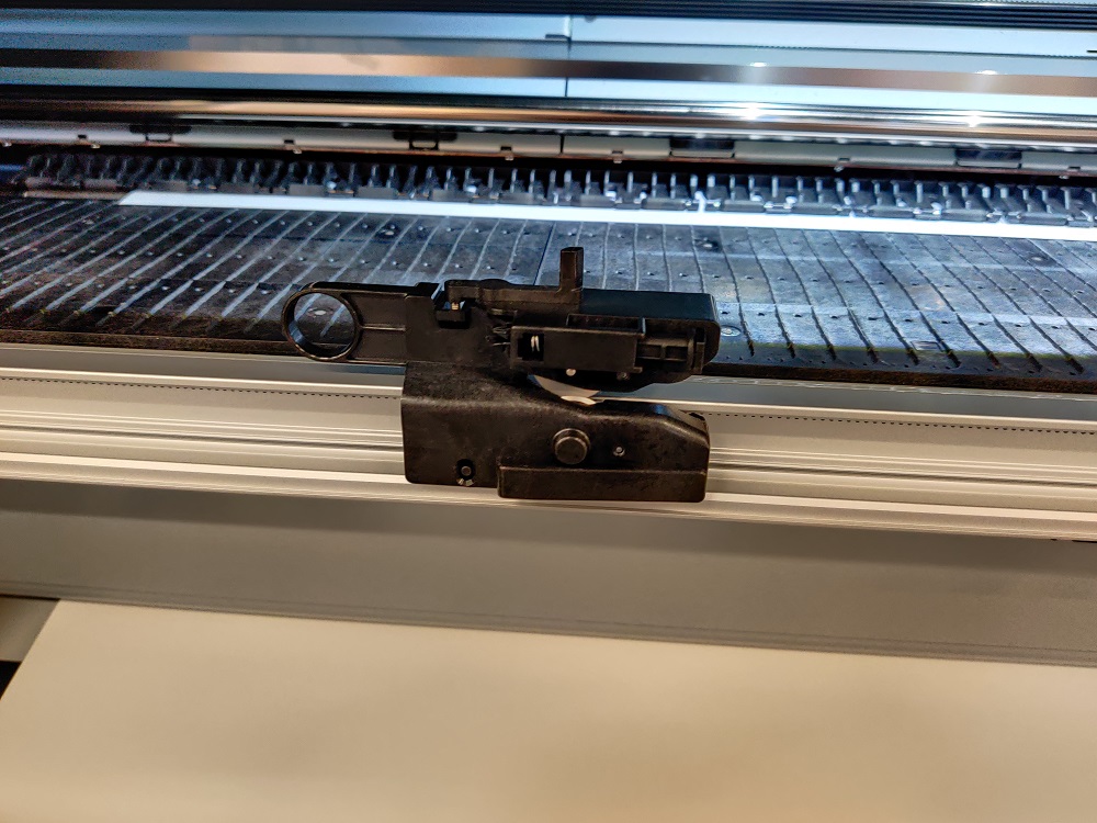

It sounds like you are describing one of the edge guards - see attached pic.On the 800W it is no longer mounted to the carriage from what I was told. When I took delivery of this machine it was just kind of sitting there on a track where it felt floppy and loose. I was told that is how it is. It functioned fine as well up until the other day. Attempted to cross cut the roll and it did not even score it. It also did not sound like it normally does when you cross cut. I'm thinking all of these problems i've been having are related. The cross cutter is sitting on the desk now. I'm not even going to attempt to put it back in. If all the issues go away I think its safe to assume that there is some sort of flaw in the new design/operation of the cross cutter.
The edge guards must be properly installed - they do not go in the gap between the print platen and cure unit where the X-cutter knife travels. The X-cutter does not need to be installed. As previously mentioned, the X-cutter is connected to the carriage.
