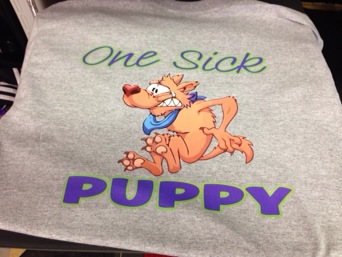

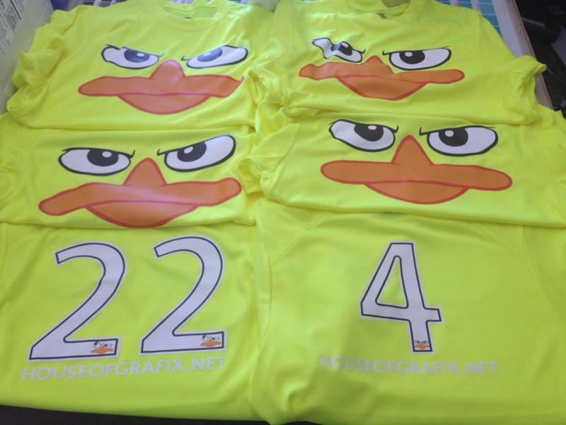

DKgrafix -- I use the crap out of Eco print and LOVE LOVE LOVE it!
attachment.php
attachment.php
