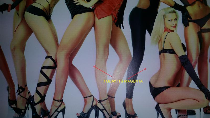

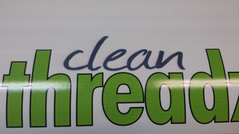

Hoping someone has made the mistake of buying a Helitin large format printer and has had the issues that I'm having.
It is using a Epson dx5 printer head. My issues a vast, I have constant hazing on all my prints no matter what colour
Today its hazing magenta to the sometimes its cyan. I have cleaned the heads and completed nozzle checks which print fine.
the pump hoses were block but I have sorted this, I have it had the machine earthed by an electrician and it still won't print clean.
Its very hard to almost impossible to get any profiles other than the one that came with the machine. I'm using 3m print media.
Would love any feed back as to what this might be

maranda151q
helitin
in the print manager, go to calibration and change media type for ppseladhesive. helitins are bad, support for australian dealer is even worse
