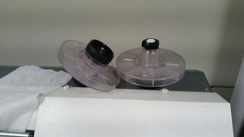

Are you using the holder thingies for the vinyl rolls? (yes that's a technical term - don't know what they are called)
Mine tracks too if I don't. It seems to be the rolls aren't wound exactly straight and sitting on the rollers appears to accentuate that. We have a lot of slop on the roll on long runs.
They work pretty good for me. Just finished full 50 yard roll of 54", loading another one. Stays pretty straight, might go off for 1/4 total after roll is done
