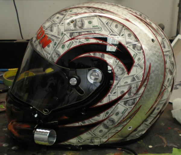

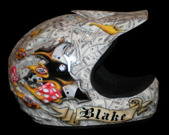

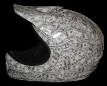

Liquid Wrap....Much easier than the vinyl... Here is a couple we have done using this method and incorporating airbrush work...Mykel

BadAss
You guys who can actually do it in wrap vinyl are pretty awesome... The ones I've tried didn't come out to well...M*

BadAss
No Liquid Wrap is not paint....It is wraped first, and liquid wrap has only a reputition of print (as in the first helmet with just the $100 bills) Then we did some with the print and added air brushing in order to give depth and more appeal...M*
