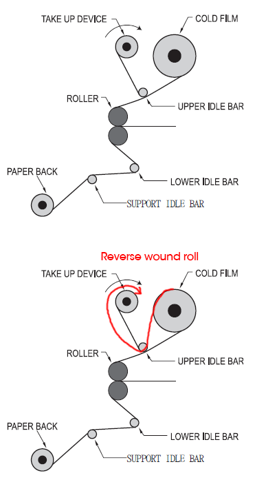

Following the manual that came with the laminator, I loaded the reverse wound roll with the film on top (see image with red notes on it)

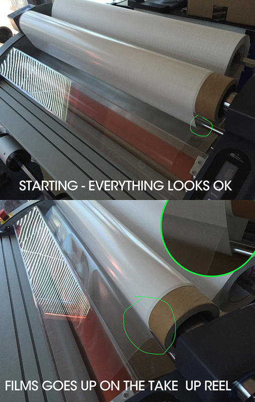

I have everything setup well, I use a board to load the film and kraft paper underneath and I have no wrinkles. Then as soon as I laminate a foot or 2 the film goes up on the backing (see image) and get stuck on the protection visor. Even if I remove the visor when trying laminating, It will eventually get all messed up with tons of wrinkles too.
I tried adjusting the tension on both the take up reel and the film reel and didnt see any improvements. Any idea what else I could try or need to adjust?

from what i am seeing in the picture. you have a lot of slack in your film.
could just be cause of how you stopped. but if your take up roll is running faster than your feed speed. it will pull up with the slack.
It does almost seem like the take up roll doesnt spin fast enough since the film always seems to go up.
Does the tension on the take up roll control the speed too usually? or its just adding tension?

Rodan68
You need to add more tension on the top roll.
Since the material is reverse wound the top roll is rotating in the opposite direction.
You may have to flip the top roll holder so the top roll has some tension and is not spinning loosely.
I'm not sure if that's possible with that laminator though.
Add tension with you hand and see if that helps.

I think I found the problem, the film roll seems to slip on top of the laminator roll insert (metal with rubber stripes).So no matter how much tension I set it at is ignored.
I am using a standard roll, is there any sort of adjustments that needs to be done on those aluminum inserts on the bar?

I had similar issues with a printer where the core would just spin around the spindle and wasn't actaully being held in place. We ended up putting rubber bands around the spindle in a few areas to give it more friction on the inside of the core. Some mfg.s just have smaller or larger cores.

Awesome! I added a few rubber bands on the spindle and put the roll back and I think it did the trick. I was able to put more tension, the film peel off right at the bar now and no wrinkles!
Probably still need minor adjustments, but it's already working a lot better. I thought most of the core were the same size, maybe Oraguard use thinner material for the roll core, the thickness of a small elastic was enough to make it tight.
