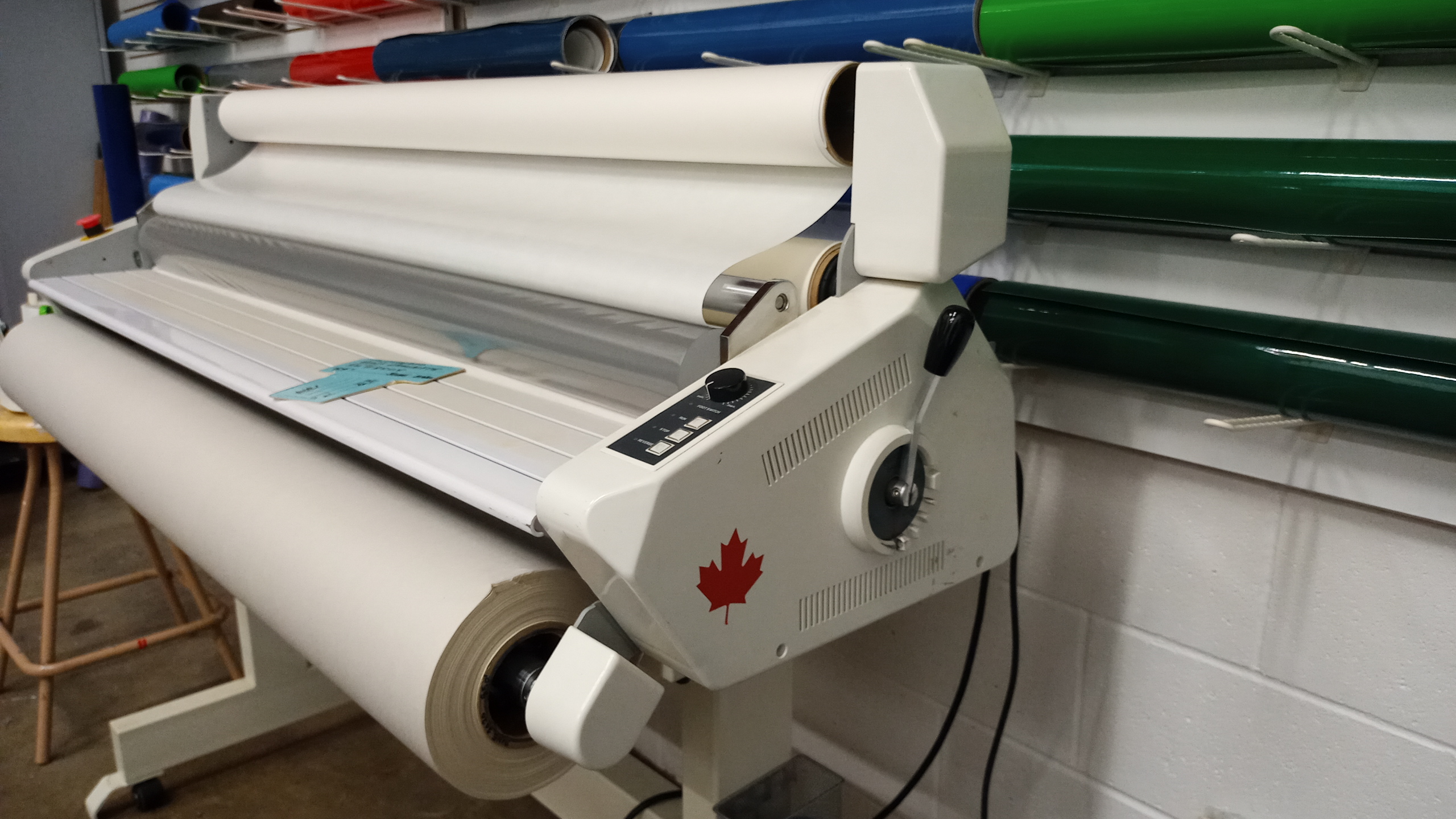

No, not with the backing still on. But I think I see the problem. If you put the laminate through by itself (without the backing), it gets stuck to the rollers. It's because you don't a have a roll of craft paper to act as the "carrier". I'm not sure if the laminator you have can accept a roll of craft paper, but here's a photo of mine. The craft paper goes on the bottom, Laminate film in the centre, and liner paper take-up reel on top. The craft paper acts as a carrier sheet to prevent the laminate from getting stuck on the rollers (and for when you have prints that are smaller than the width of the laminate film).
If you can't use craft paper (based on the photo in the link you gave, I don't think your laminator is designed for this), you could try using a thin sheet of coroplast or sintra, or even a sheet of cardboard would work as the carrier. Just make sure whatever you use doesn't have sharp edges that could cut or gouge the rollers.

Lindsey
Not A New Member
Hi guys, just to let you know that today it all went abit ski wiff again! lol. I should mention that the last 2 weeks I have been using a slightly narrower roll of vinyl that I am overlaminating. Before I was using the same width of vinyl as the laminate. However both times I have had issues with wrinkling and also on both it has worked fine sometimes! So this time with the narrower vinyl and wider laminate roll, I have had to use a sheet underneath the laminate to make the vinyl wider going through so that the laminate doesn't stick to the rollers. I realise now that this is now the ideal scenario, just didn't realise it at the time when I ordered the new vinyl! Next time I will order a narrower laminate to match the vinyl. Narrower suits me as I have short arms people! Found it hard to load the wider media. So anyway...for the backing sheet on the vinyl to make it wider I just used the backing paper from the laminate roll, that really thin stuff. Is that a bad idea and will it not work well as a backing for this purpose, could that be causing wrinkling also? And can anyone advise what other material that is cheap and good to use for the purpose of backing the vinyl to make it wider? Please please don't tell me shouldn't do this as I didn't want to waste any material, trying to improvise at the moment til its all finished, will order correct size next time! lol Unless you really think its an issue of course? :) Thank you!
Using the liner/backing paper from the laminate as your "sheet underneath" is better than nothing, but because it's so thin and flexible, it might be causing you some trouble. Something stiffer and rigid, like cardboard, coroplast, sintra, or polystyrene might be better. If you need to, you can use masking tape to attach the vinyl print onto the cardboard before you send it through to help keep it in place. In the laminating world, these stiff carriers are called "sleds".
https://signs101.com/threads/laminator-sled-material.58168/
This isn't quite exactly the same as how our laminators work, but here's a video that shows the concept of the sled. You can place or attach the print onto the sled, and then send it through.
