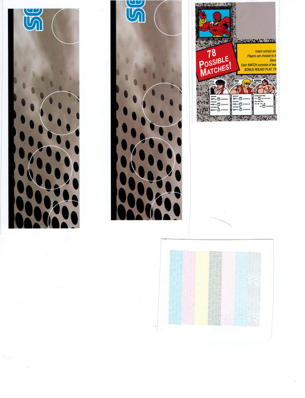

3) By printing test Roland files and also some print tests, it appears like the nozzles are ok (except the silver that is a bit clogged, the others seem good). However from my prints, I thought everything was tinted pink but I also noticed issues with dark colors and the gray using Roland charts. See my print tests here: https://dl.dropboxusercontent.com/u/38670017/20160314---print-test.jpg (also attached)
a) You can see that my prints all came out a little pink.
b) The dark colors seems to have some horizontal lines in them (its not showing here, but I get similar lines when I try printing solid metallic)
c) The grays printed and the ones from Roland chart are very different, mine came more green then gray, even the brown is gray and purple shows as blue.

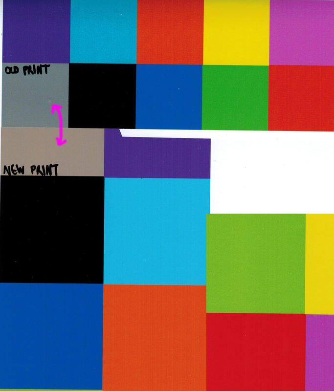

here's also a scan of different prints of the same color test. See how the gray changed from the old print to the new one (pink tint). This is from the same exact Versawork job.
