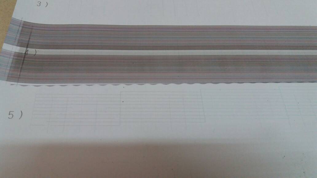

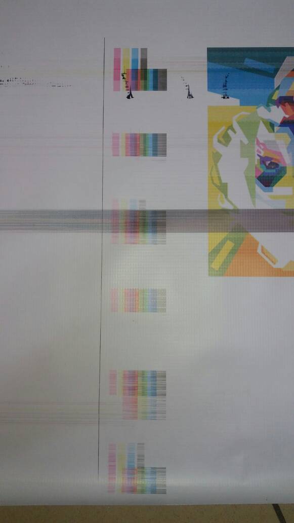

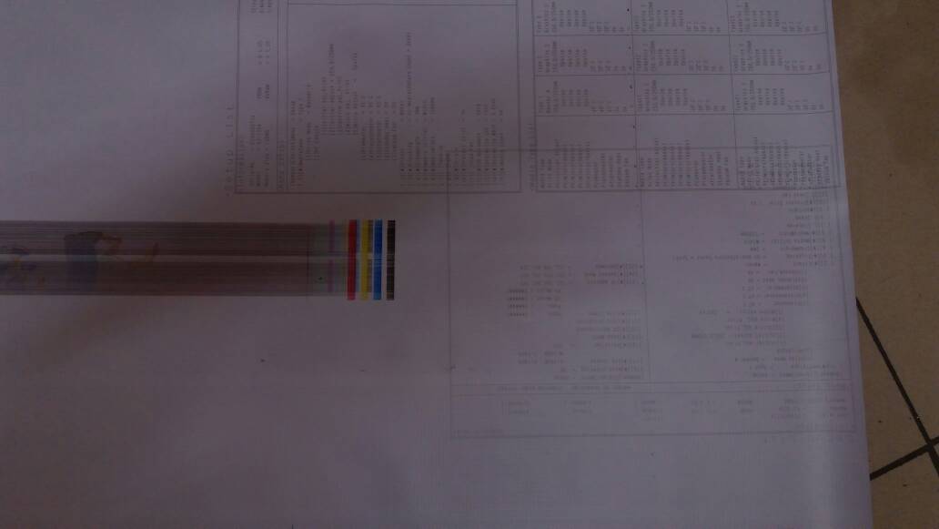

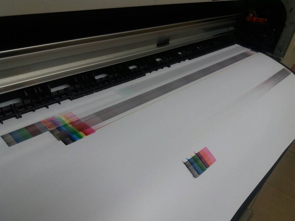

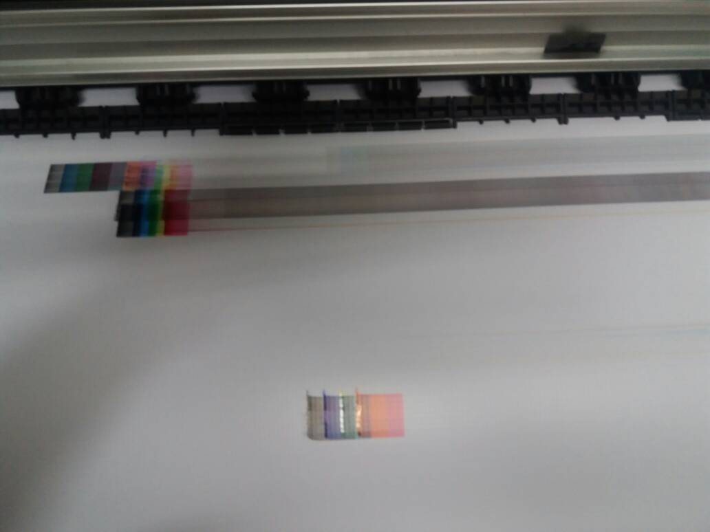

hello my friends i know this is an old thread, but i have the same problem with my vj 1204, check the image, i buy a new print head whit a flat cables new and one kit of maintenance, i try print but E074 err Current Cr and the carriage stop in the middle of the printer, and later of reset the printer send a new print and i have this...
See this
print and after 11 pass print a band of black combined just like that
please help me... i don't know what happening.

Try taking the long top cover off of the machine and run a print that way. If it works, your CR cables need to be changed or just run without the cover on as long as you can.
See this

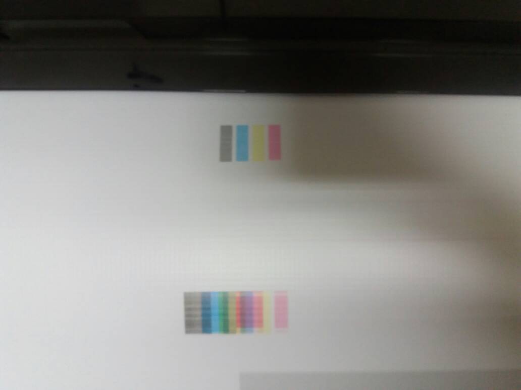

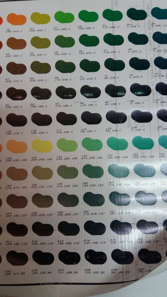

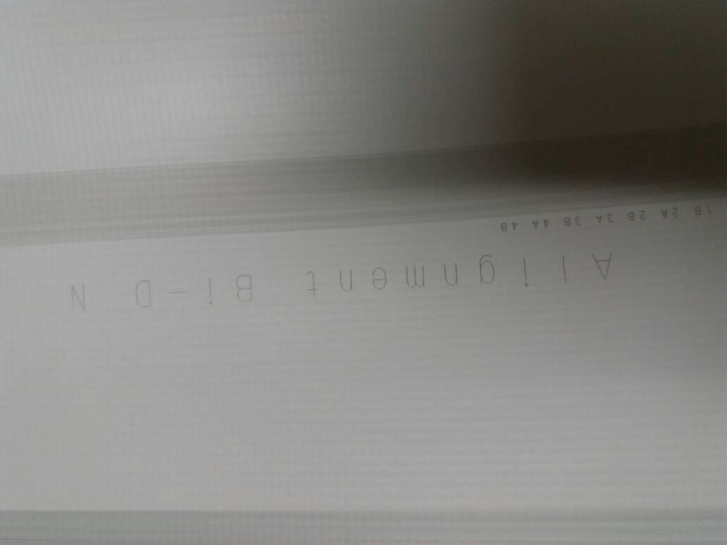

I try this, like you recommend and still have problem... print and every 11 pass or less send a error, print a band of black, but if i send a test like a bid adjust print well, and sometimes the carriage stop in the middle of the printer.

Thanks but i replace the t fence or encoder strip and now only have this problem on bad print or band of black in the image
