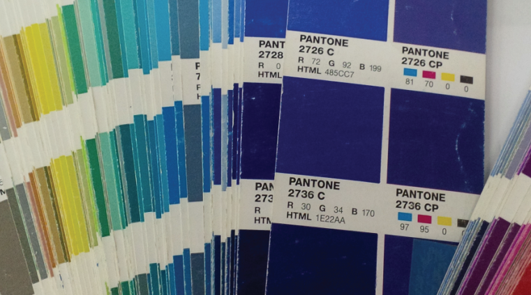

I need help finding a PMS color to match a vinyl color, or at least a CMYK value.
The vinyl is Avery Olive Green (900 supercast), SC 900-765-O. The closest that I am coming to it is PMS 576 c. I know it won't be a perfect match, so close will work.
Any help is appreciated.
myront
Dammit, make it faster!!
Your Pantone color swatch thingy should have the cmyk values under it. Don't go by the program conversion. You'll have to go in and alter those values in order to get closer. We do this all the time. Create several squares, leave the first square at the exact pantone color then just alter the others a bit. Print all the squares and see where you get.
