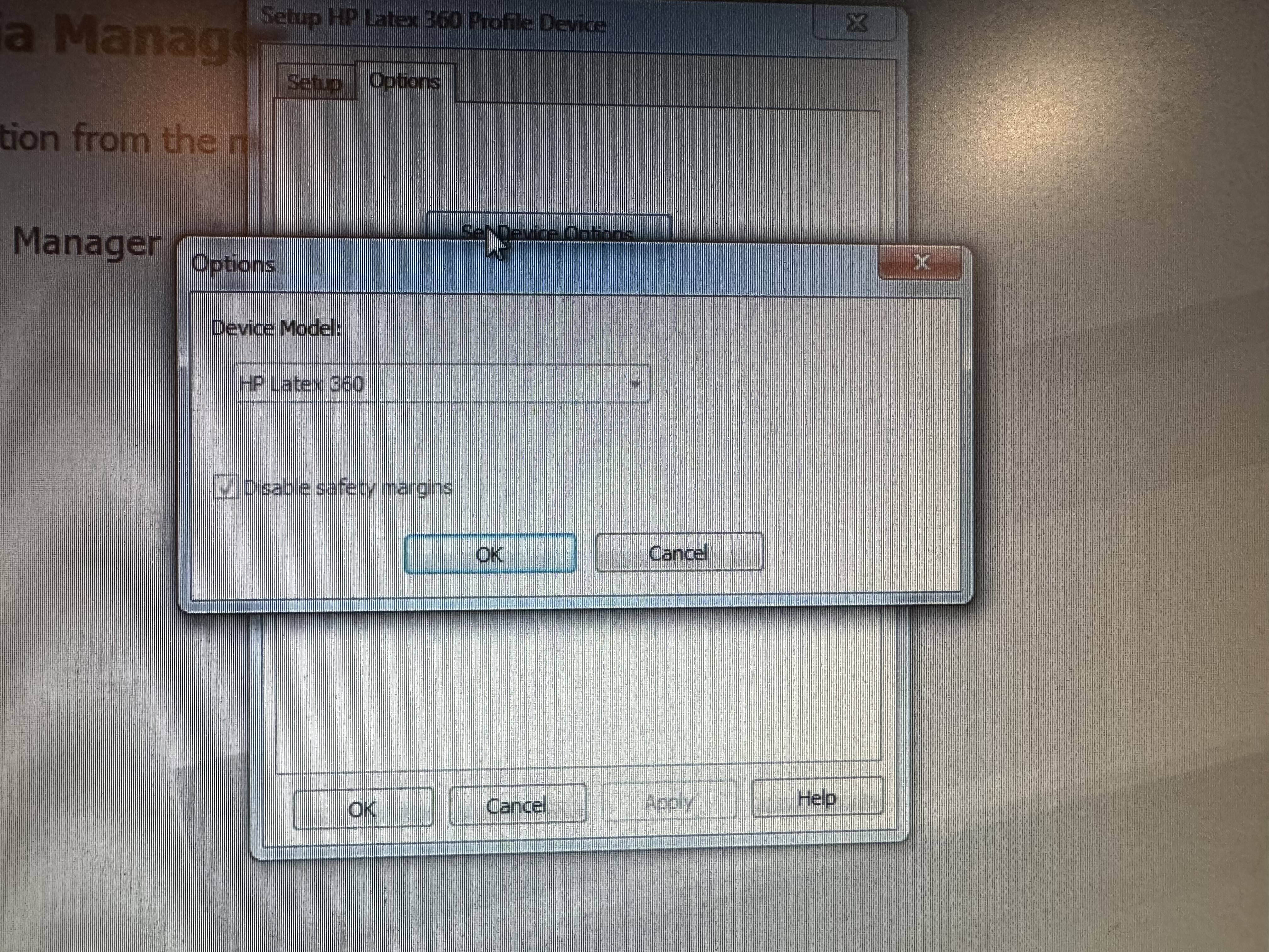

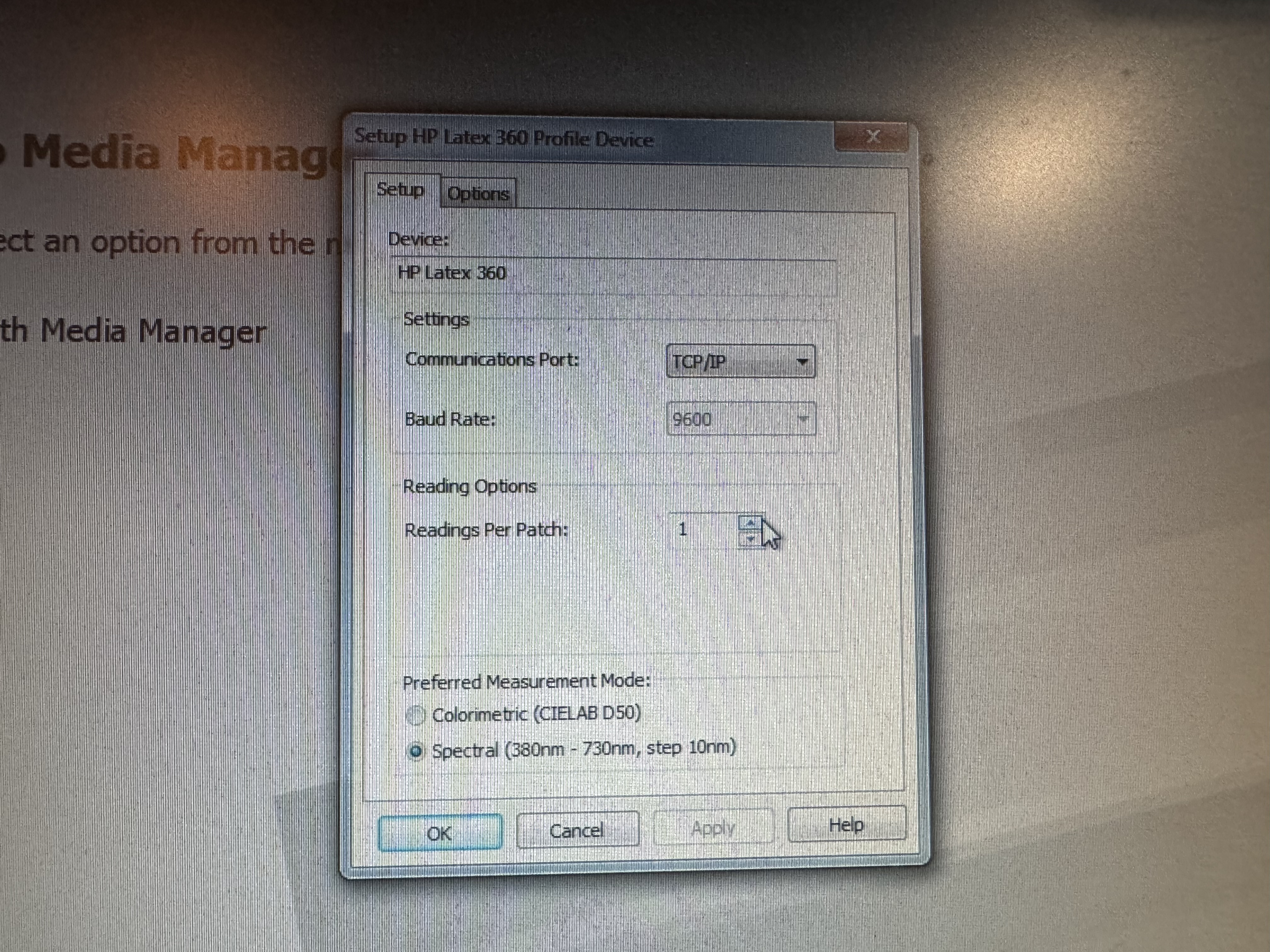

I was trying to calibrate through onyx. Have an onboard spectrophotometer on 360. Mapped it to the printer. But for some reason I can’t get the onyx to print swatch for the printer to read swatch didn’t know if I didn’t set it up right. Attached are some pic of where it’s being mapped to in onyx. It said that the ip is good but onyx will not let me print swatch. Or was I told wrong and it won’t print swatch and read.
On a side note it will print the internal calibration and read that on the 360.
Thanks

I only ever ran demos of Onyx that let me print targets and imported the measurements, so I don't know if there are versions of Onyx that do not support that. Maybe someone with Onyx experience can help you out here.
