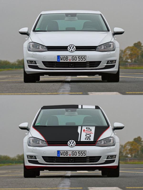

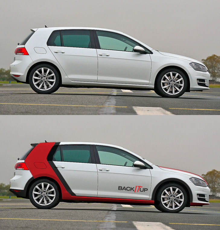

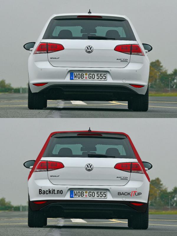

Hello to everybody. This days i get a price request for a job.Usually i do only simple jobs, mont logo, stickers but i want to try a bit more. So i need some advice for the tehnics which you will use for the job shown in attached pictures.Red line, next to the black, from hood i should use knifelles tape or cut a line and mount next to the black? Also the white graphic from hood i should cut them in black, or cut in white vinyl and mount them over the black?
You can see some of the jobs what I'm doing here www.foliexperten.no/bildekor/
I don't have very much experience, so every advice is welcome. Thank you in advance.

I have had great success with the knifeless tape. When I've had to do something like the above photo with two colors at a set width apart I will use a corresponding width of masking tape to follow the contour of the first tapeline, and then lay the next run of knifeless tape along the edge of it.
