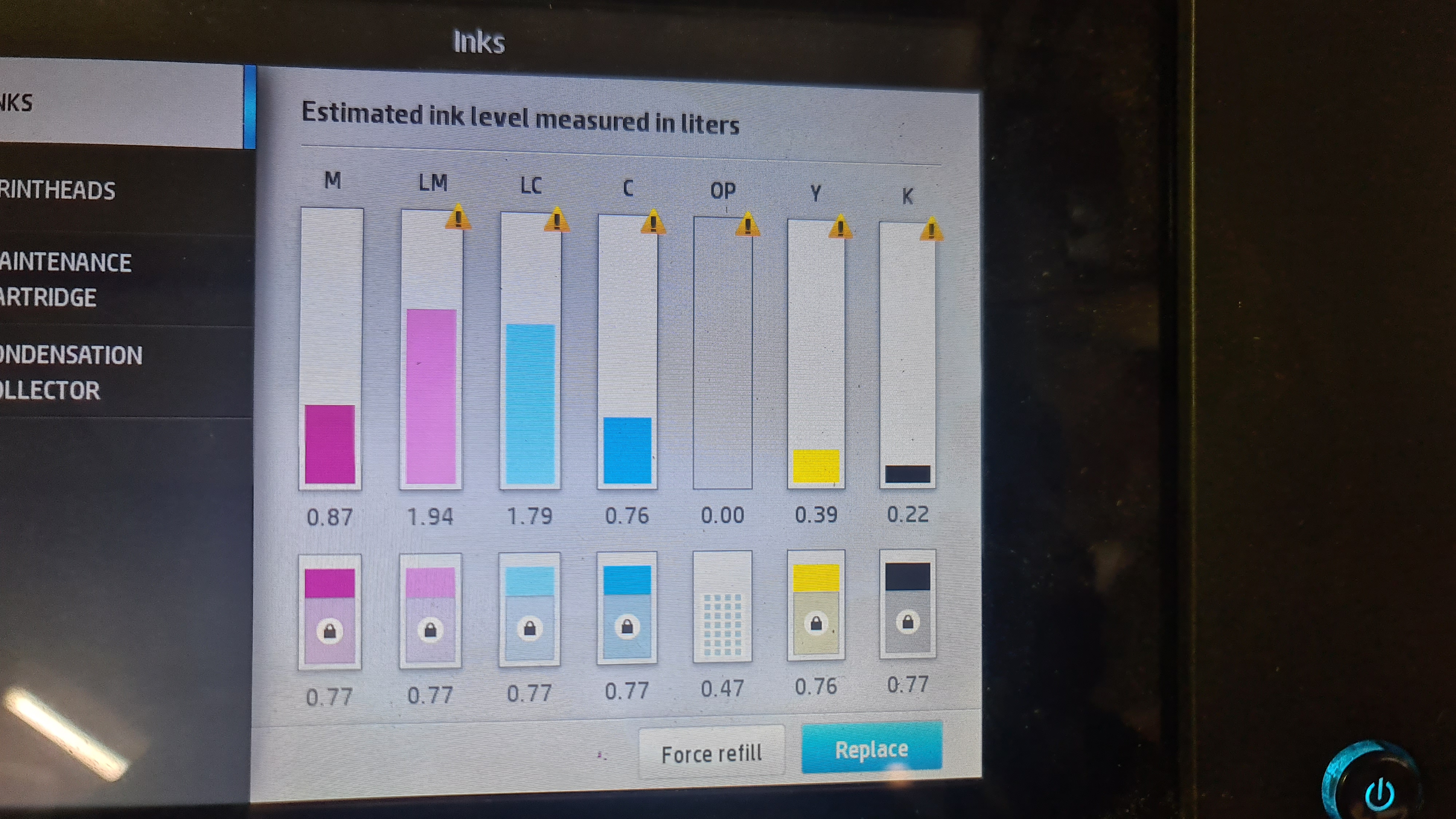

HI,
The OP intermediate tank keeps emptying tank, I changed 3 new OP ink in the last 6 months. the OP intermediate tank won't pass 0.5L.
when I click 'Force Refill', the printer stop the process very soon.
then there is a 'X' icon on the 3L OP ink. also the amber light turns RED.
when I click 'Replace', and reconnect the 3L OP ink, it shows 'expired ink warning', click 'confirm'. the amber light turn GREEN.
when I repeat 'Force Refill', the same issue shows again, the refill stops very quickly, and the intermidate tank is not filled any more ink, stop at 0.5L.
The printer stopped working completely last Friday. unfortunately I run out of OP ink(775ml) and have to wait new ink coming in next Tuesday.
What can be the main cause for this issue? air bubble in the tube? failing PIP? pump? expired 3L tank?
I haven't take it apart yet. Your advice will be much appreciated.
Thanks!

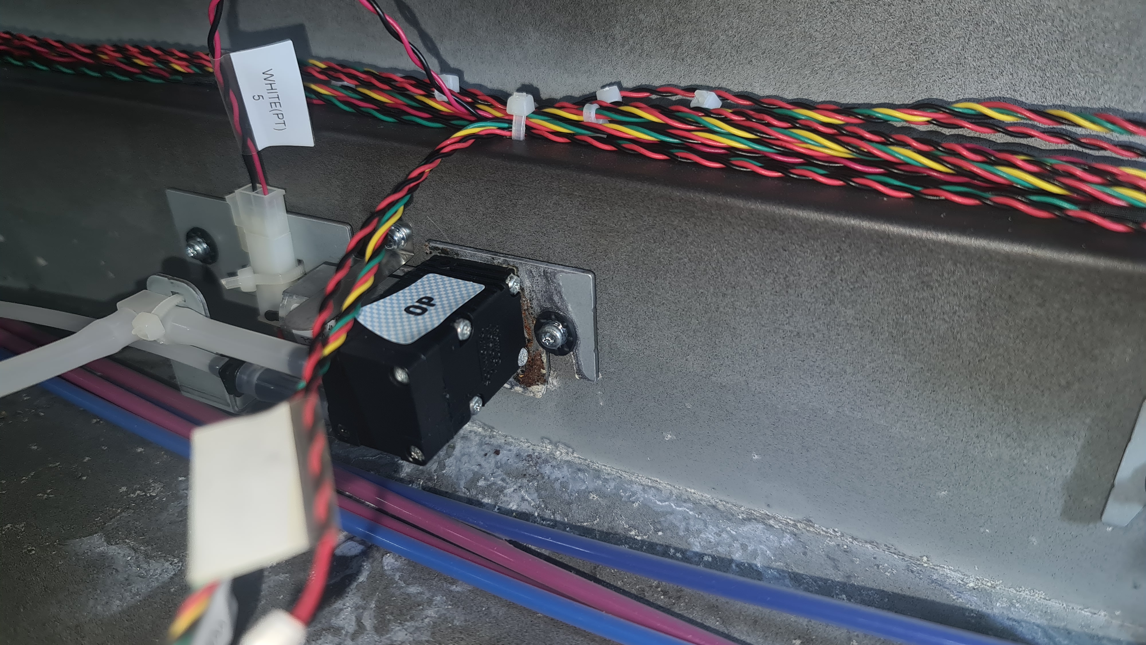

Steven.Cao
open the cover for the ink pumps.
I found out the leakage around the OP pump area.
Can I just replace the pump or I have to replace the whole OP ink pipe with pump?
First time I have this issue.
any advice will be great! thanks!

ToTo
Professional Support
Switch off the unit, unplug air tube somewhere to release pressure and disconnect all supplys. Open the pump head and clean the membranes and plastic parts and reassemble everything. Maybe you should flip the membranes .
Don’t forget to reconnect the airtube…

I installed a used pump and replaced a new OP intermediate tank in November.
The printer worked well in Nov and Dec, probably 1-2L OP ink, now there is only 0.47L left in the OP intermediate tank. the printer doesn't show how much ink is left in the OP 3L tank. I guess 0.5-1L in OP 3L tank.
The force refill function doesn't work for the OP intermediate tank, It won't pass 0.47L.
I check the OP pump and ink line, no air bubble.
Any suggestion, Thanks!
