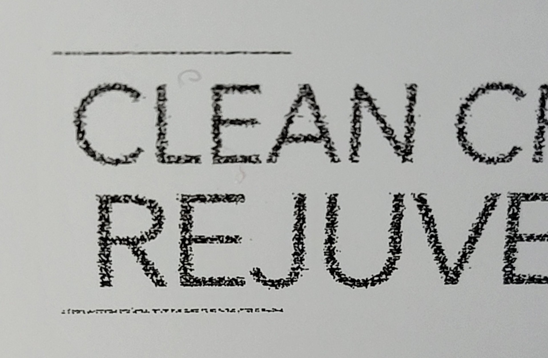

I do a lot of labels as part of my business and when it comes to smaller print in gray it comes out grainy almost a speckled look. How can I achieve a full color gray even if it is in small lettering. When I use cmyk it turns out brown and the same with rgb. I have tried running the print on standard and on high quality and they are both the same. My printer is a Roland sp-300v and I am using official roland ink. please see attachment

as far as the graininess, it is a limitation of the 4 color printer that it renders light cyan & light magenta by having cyan and magenta dots surrounded by white space. (hence graininess)
using an appropriate profile can probably minimize this effect. you can obviously render grey without light cyan and light magenta.
speaking of profiles, if you generate a proper profile for your machine, the grey should be grey(er)

This won't be possible with VW and this printer.
What you need is a printer with LC/LM/LK. A VSi for example.
If you want to finetune black generation and have (more important) dot size control, you need another full featured rip, that's probably more expensive, than a used VSi printer with Versaworks 6.
Roland predefines dot size usage. You can generate linearisations in Versaworks and assign profiles created in a 3rd party software(where you can influence black generation).
