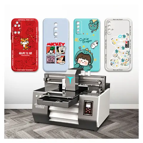

thanks for replying friend,
Machine make : Shenzhen Lingya Co Ltd (China)
I have machine from last 3 months & it was printing before, but suddenly it was spreading magenta color & not printing black color & then it was printing nothing, hence replace the new head of TX800, but no printing at all with new head.
