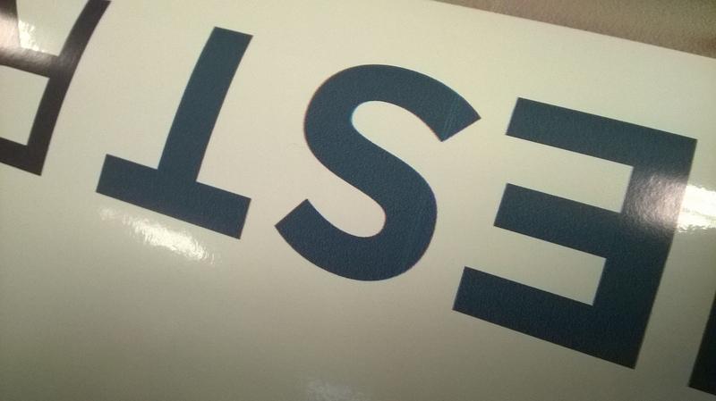

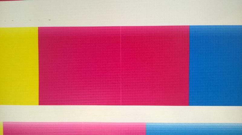

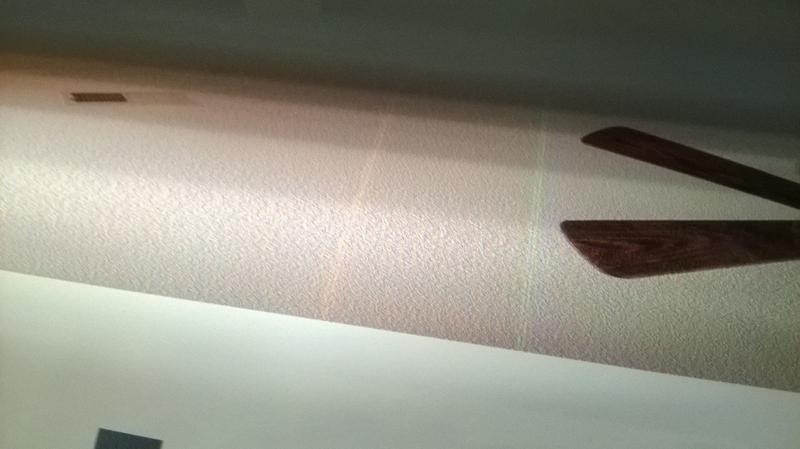

I have a "line" showing up in all of my prints. It is in the same location on the printer. Any thoughts? I noticed on the one sample I attached, the color seems to be out of register, but it is only in this area. The rest of the print is fine.
Roland SP-540V.

I would start by cleaning the encoder strip, there might be a small spec at that point along the scale
DO NOT use solvent cleaner
timkaz227
Perfect!
Thanks, I don't know why I don't think about the encoder strip. Cleaning it solves so many problems.
Thanks Again.
WRAPIFY
Looks like possible bad/dirty vinyl/media? Try different media on the same machine. If it still shows on media you know is clean then yes, it might be the encoder strip needing a cleaning. Beyond that, are the pinch rollers in line with this issue? We have had a pinch roller cause the media to be "dirty" which causes the ink to not adhere to the media properly once it is fed under the print head, similar to finger prints.
Could you have a pinch wheel that's contaminated or something ?? If it's at the same exact spot, I would think something mechanical/physical is causing it.
Reason being, it looks like the OP showed 3 different medias.
