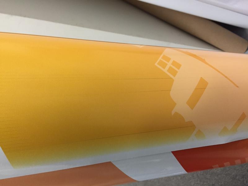

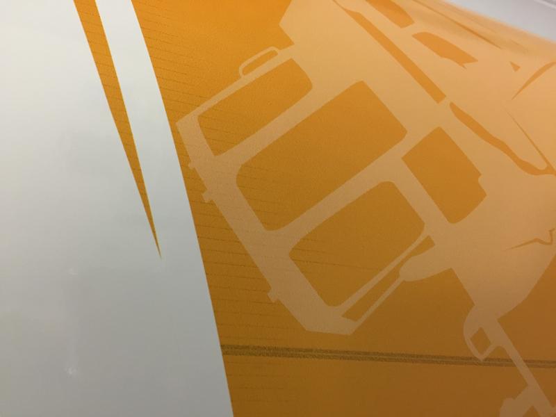

Hi everyone,
I am a newbee here. I am having issues with my Mimaki CJV30-130 banding. I feel like I have tried everything but I doubt that, I come from a Roland background and when moving companies I didn't get much training on the Mimaki before the previous person left. I go on Maternity leave in 6 weeks and would like to fix it before the next person takes over.
I am having banding but only when printing Yellow & Reds (I have attached a picture to show you what I mean). My heads are fine, and even after a clean the banding still happens. Throw your ideas at me and I will let you know if I have tried that or not. I had a tec in to do a service and everything seemed okay but a couple days later it was happening again.
Thanks, Kirsten

As far as your printer goes, it looks like the bottom of the head either has inkcicles hanging down or you are getting cross contamination in your yellow which is right next to the black. Make sure everything is as clean as can be. I would start by checking the pump tubes for any clogs and change the cap top. If everything is working properly below the head, I would look into changing the dampers. One thing i always check is the wiper because if that is not moving back and forth properly it will scrape the head while it prints and get dark ink on the bottom of the print head causing the issue you have now.
