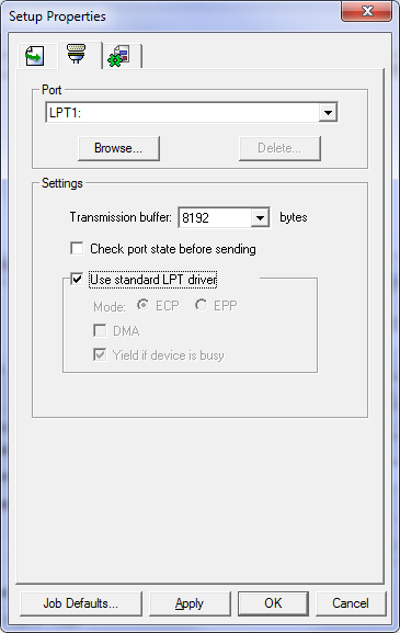

Standard LPT Driver
My Falcon outdoor Jr used to do this. I then made sure "Use Standard LPT driver" was checked in Production Manager under setup properties. This fixed it for me. See pic
