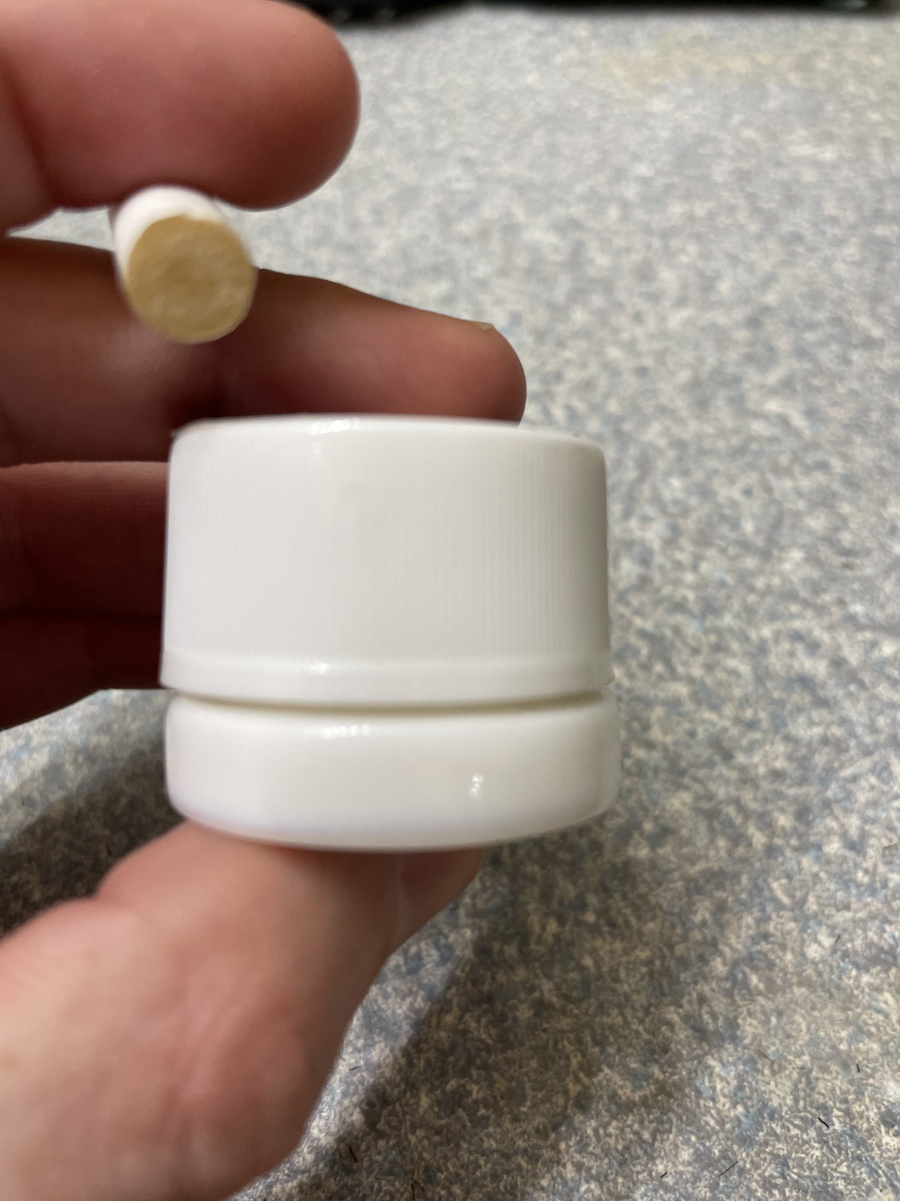

Hopefully you guys can help me. Im trying to print labels for these small jars "pic attached" needs to be able to print on eco solvent printer and cut on a roland cutter. I tried roland glossy adhesive paper and it just peels off after a few min. I dont want to use vinyl because these are tamper labels that need to be easily ripped with finger nails to open product. It needs to be high high tack. Take a look at the jar in my pic and you will understand. It has to wrap around the whole jar.

I thought you wanted them to be easily torn? Just use vinyl, and cut a dashed line where it needs to tear. Adjust the dash length and spacing to suit the difficulty of tear you desire.
