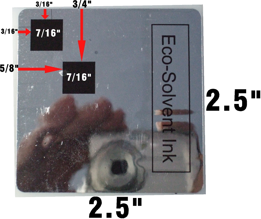

Hi. I know is a long time ago but do you know or remember how to make the printer recognize ink cartridges not original? I have found something about cutting and replacing the original label on the ink tank but I don´t have the original inks with stickers. Is it some special sticker, some say is a silver foil... I would lie to know exactly what to do. Thanks.
RG
Yes, mirrored chrome foil form an Edge printer or cut chrome vinyl with the 2 black 7/16" squares stuck on it in the right place should work. The "card" on all 4 colors looks the same to me. Hope this helps.

tetonsio
Thank you sir. You really are a good help, thanks for taking your time to reply and send me a picture, finally someone did. Thanks again.
RG
You are welcome. I started out with a FOJ printer. It served me well for 5 years. When you stick your new "card" on the cartridge, stick it about 1/16" back form the end of the cartridge and butt it right next to the lip that hands over on the top of the cartridge. If you have trouble finding cartridges for your FOJ printer, ValueJet 220 cartridges will work. Just remove the smart card that comes on the ValueJet cartridge and apply your FOJ custom made "card."

Valuejet 220, ok. Let me tell you, looks incredible but someone had this Falcon printer new in a box for years and decided to sell it. As an old but "new" printer I decided to buy it and try to make it work again. The printheads were flushed after a show years ago, so I hope they be fine. I just did all tests with the hidden menu and everything works real good. My only problem are the ink cartridges, too expensive 6 colors just to test and maybe find that I have to get new printheads so I decided to look for refillable cartridges. Now I will try with your help and see what happens. I will let you know as I think you deserve a lot of credit by helping me.
RG
Sounds like a plan that just might work. If the heads were flushed, they should be OK. But, the rubber on the cap tops probably is no good. You said "6 colors", so your printer doesn't sound like a FOJ printer. And, I know that you can not buy just the cap tops for a FOJ printer. You have to buy the whole maintenance station. If you try it with the cap tops that are on your printer now, be sure to use a swab with some cleaning fluid and wet the rubber part of the cap tops before you try printing anything. You might want to stock up on some o-rings for the ink lines and some new dampers, too. And, check the rubber on the pinch rollers to see if it is sticky.
Well, it happens that as I never used Mutoh printers, I found a lot of names for this printer. The label in the back shows SDMP-46J... at the front cover says Falcon Outdoor, in the Manual I found it says Mutoh Rockhopper 46, and some others Mutoh Prismjet, the name given by Signwarehouse. Also AGFA shared this model with its own name. Anyway, yes, it is 6 colors.
I will clean all that as you say before trying to print. I am waiting the refillable cartridges to arrive. Meanwhile I am building the Waste Ink Tank base as it did not come with the printer. It has a little switch that you know for the ink to be recognized. My only problem with it is to know if it is a pressure switch or an optical switch as I removed a pressure switch from an Epson desktop printer cover to adapt it. I don´t wnat to connect anything until I be sure won´t damage the mainboard.
