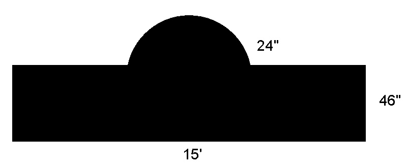

Hi, I've been making flat signs for years, and recently made a few pan signs by routing a groove in alumalite or 3mm acm and folding the edges. I've done a few multipanel signs as well with alumalite and dowel pins. Now I have a customer who wants a sign that is going to need three panels -
attachment.php
So I was planning on bending 1" edges and butting the returns together, and fastening with bolts and fender washers. Question #1 - is that a sufficient means of joining? Do I need to use aluminum strips or even angle pieces?
Question #2 - How do I fab the return on the curved part? I'm guessing I need to cut a strip and attach with a bunch of corner brackets - if so how often do I need to place a bracket? And Gorilla Glue or should I use some Lord's acrylic?
Last but most definitely not least, I am installing this on a stucco wall. I was planning on attaching strips of angle to the wall and using rivets to attach the sign. Does it make sense to attach the 4'x15' rectangle to the wall, relax the return along the flat side of the semicircle, rivet the flat to the top of the rectangle (with predrilled holes natch) and then just tip the semicircle up and rivet it to say three small pcs of angle, maybe at 11 o'clock, 12, and 1?
Thanks much,
John
Whoops, question #4, do y'all think a regular 90 degree router bit is okay to use, or do I need to get one with a radius bottom for really good seams?

First, I would never use ACM or Amualite for "pan" or dimensional panels.
You might want to think about hidden attachments, rivets, exposed hardware
of any kind looks cheap unless it's somehow incorporated into the design.
I would use an aluminum panel.
Use angle at the edges, when you get to the radius, kerf cut the angle and bend
to follow the aluminum.
Lords Adhesive the angle to the panel.
The attach flush to the wall, attach angle to the wall that will fit inside the sign.
Slide sign over, the screw in through the sides. No exposed attachment on the
face.
MikePro
I'd be saving myself a headache trying to fabricate the return for the rounded-part, by subsituting some "filler" in the form of 1" HDU.
1) build a triangular frame with your 1" returns, bottom-square portion-only
2) secure your routed panel to the frame, however you wish, this includes round portion on the top
3) "fill-in" the rounded top-portion with a piece of routed 1" HDU (or PVC), secured to your routed panel and sits flush atop your frame.
jtiii
I paid good money for you to read this!
Mike, thanks for the information, the foam makes a lot of sense. What do you mean by a triangular frame?
John
jtiii
jtiii
Alternatively I don't necessarily need to have pan faces, I could go flat to the wall, but I'm not sure how I would join them.
MikePro
John
this is a 3-sided sign right? with a 1" return?
build your structure, skin with panels, fill-in missing return for the circle with plastic/wood
edited: oops! nvm, misread the OP. its just a LARGE sign that will require 3panels to complete. I got it now.
if you're still looking to make a 1" return, maybe build a frame on the wall with 1" wood/alum, and then secure your faces to it.
here, we would use routed .090 aluminum faces with welded 1" extruded alum angle. angle is notched/rolled for the circle. all seams are then usually filled/sanded prior to painting.
To install, we would then mount some angle at the corners/centers of the perimeter on the wall, and countersunk screws to secure frame to them.

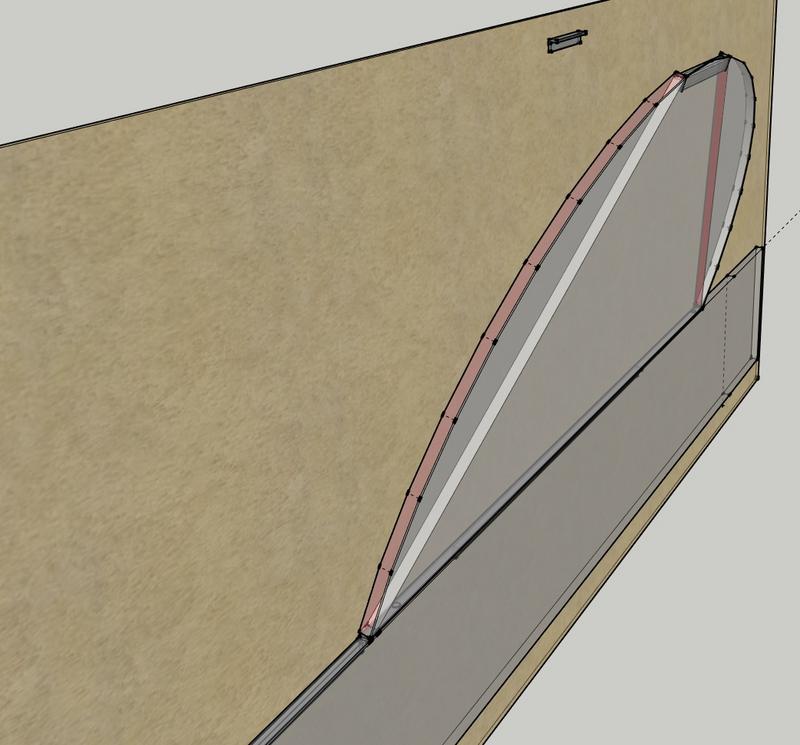

Mike and Rick, thank you both for the time you spent addressing my questions. Thank you for your candor. I don't know how to weld aluminum and I have already accepted this job, so I'm going to produce it as I described initially (I may switch to alumalite on the rectangular portion for some added rigidity). I am going to mount the rectangular portion to the wall, then use the bottom return of the half round as a hinge, affixing it to the rectangle and then tipping it up to the wall. As the sign is well above eye level I plan to mount some angle at the top of the round and mate it to angle on the wall. Here's a picture -

Rick
Just wanted to add that the method I described does not require welding.
