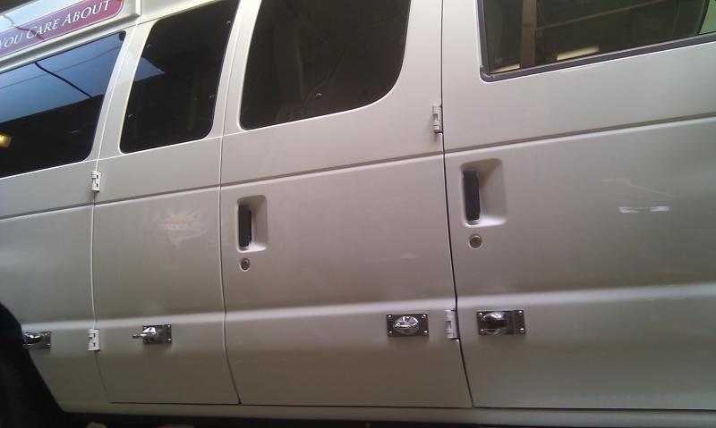

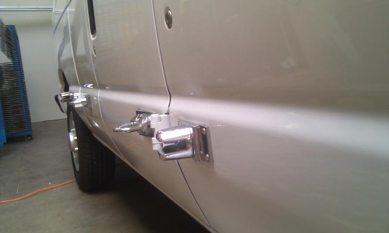

I am doing a partial wrap on a new ford van. it is handicap accessible from one side, and so has large metal pieces coming out of the side of the vehicle that hold the door against the side of the van when they are open.

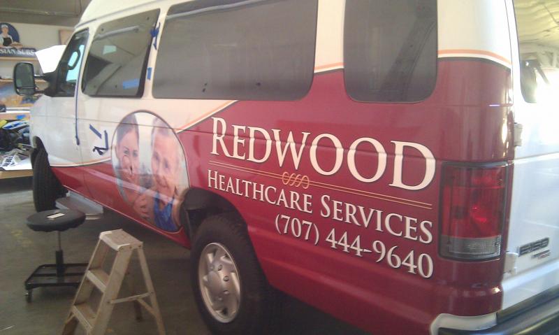

We already did the other side, and it came out great. Just wondering if anyone has any helpful pointers or suggestions on how to get around these cleanly, as unfortunately, they cannot be removed. I would have to disassemble the whole door to get the nuts off of the backs of it, and still, wouldn't be able to reach all of them. Anyone dealt with this? pointers?

It isn't hard to pop the door panels and take those brackets off. 3 or so screws and maybe a clip or 2 and your able to remove the panel for access to the bracket fastener. As for the one by the rear tire you might have to loosen the inner fender shield to get to that one.

Sure if you want to take the interior panels out to hold the nuts while you unscrew the screws in the front?
Do how prowraps suggested.
4R Graphics
Like Pro wraps said
Apply the panel and trim as you go around the brackets not hard just have to go slow and trim straight.
