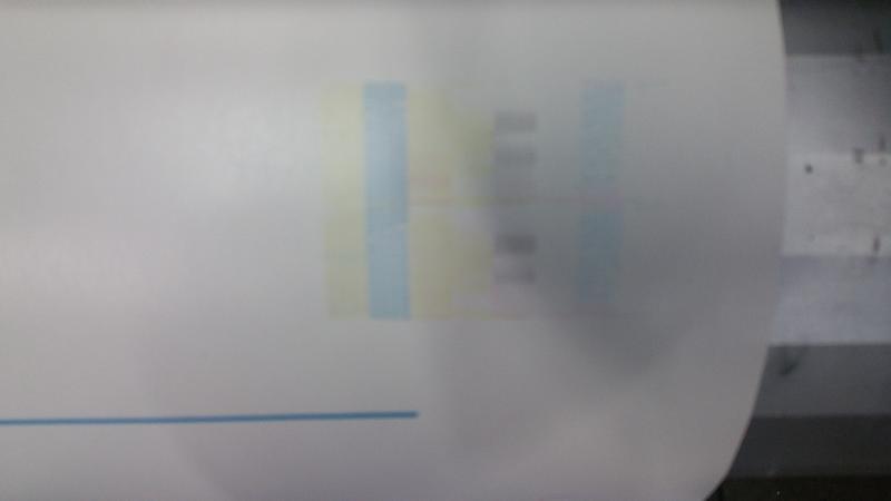

Started acting funny last week, was printing on translucent and had bad banding. Did a nozzle check and lc was showing a lot of missing nozzles.
Did a head cleaning and lost most colors and even after using syringe the colors were gone..

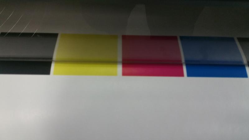

I have replaced dampers, cap top, and encoder strip after problem started... I'm thinking it mat be the head but what's funny is if I start printing the colors will come back but nozzle check still bad.
