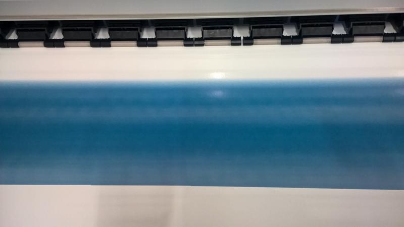

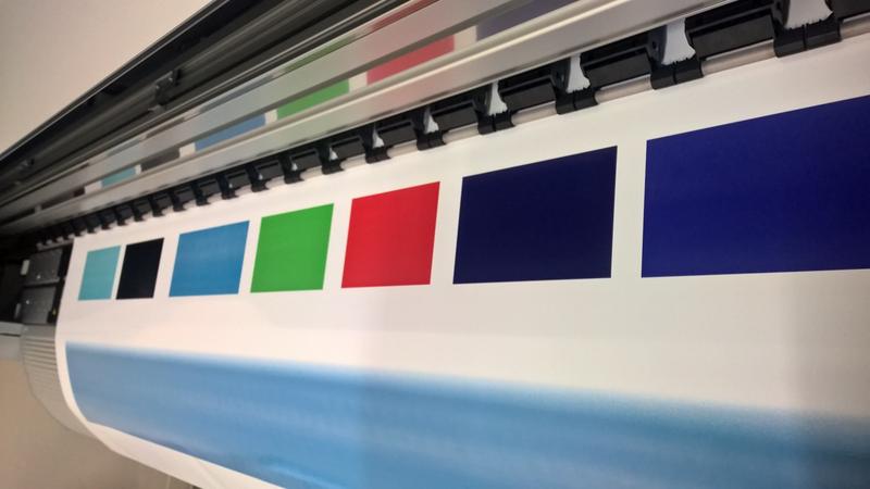

Here is a picture of the issue I am having. Trying to print a solid color blue for vehicle wrap. Printing with a mutoh 1624 on Avery 1005 material. Black is printing great but getting an 'airbrushed effect' with solids as if there is not enough ink. It's a holiday and i'm stuck cuz mutoh is closed. Can this be a profile issue? I also did a color swatch test of various colors and the 2 lighter blue have the airbrush effect but the other solid colors look great! Thanks for any help

Tried that too. The sample that is in the picture is at setting Quality 4 720x1440.

If it were media you would see across all colors...if you increase resolution/pass mode does it go away?
how old are inks? Check the date. I would pull cartridges and agitate ink just to be sure then run a few cleanings to cycle ink...
I might try to go the other way with your heat...lowering temps...usually if temps are too low you can see white specs...to high Ihave seen vertical banding...
since it appears only in cyan...it may be physical head alignment/service calibration/ ink/ or a faulty head
