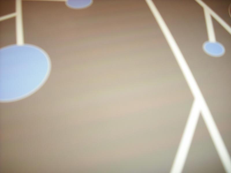

My printer has actually done this for a long time, but never this bad... Usually only noticeable in solid coverage areas, some colors it shows worse than others.
Not sure if you can see the detail in this photo, but it is printing some weird lines through the artwork, and it is NOT in the same direction as the head is traveling, it is the other direction, not like banding. The lines are blurry and they seem to alternate in colors from a reddish tint to a greenish tint.
Has anyone else ever had this problem or know what it is??? Thank you in advance.

it seems to be most noticeable when printing greens, but does it on lots of colors actually.. my print/dry heaters are at 108/112

A dirty encoder strip can cause strange things to happen. I'd start there, clean it and see if that helps.
