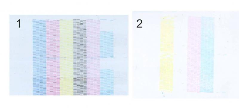

It all started with a banning in blue and red prints, and from the test print we started to notice a missing part on light cyan and metallic, as in the attached foto test print 1. To try and solve this problem, we did a circuit cleaning with cleaning liquid using fill ink and we changed the light cyan damper. As written on the service manual, we then did a powerful cleaning and a choke cleaning but the test print was a lot worse.
In doubt we then changed the dampers for all colors, we did another powerful cleaning and choke cleaning, and now we have a plotter that is printing only 3 colors: white, yellow and light cyan as in foto test print 2.
Our feeling is that the choke cleaning, which is supposed to be used to eliminate air in the system, doesn't do so at all.
Before putting the new dampers in (not original), we tried using a syringe to eliminate air bubbles, but neither has this solved our problem.
Checking the ink tubes, we can see on the white and yellow a small bubble of about 1 mm, but the test print of these colors are ok. We can't see any air bubbles in the other tubes.
