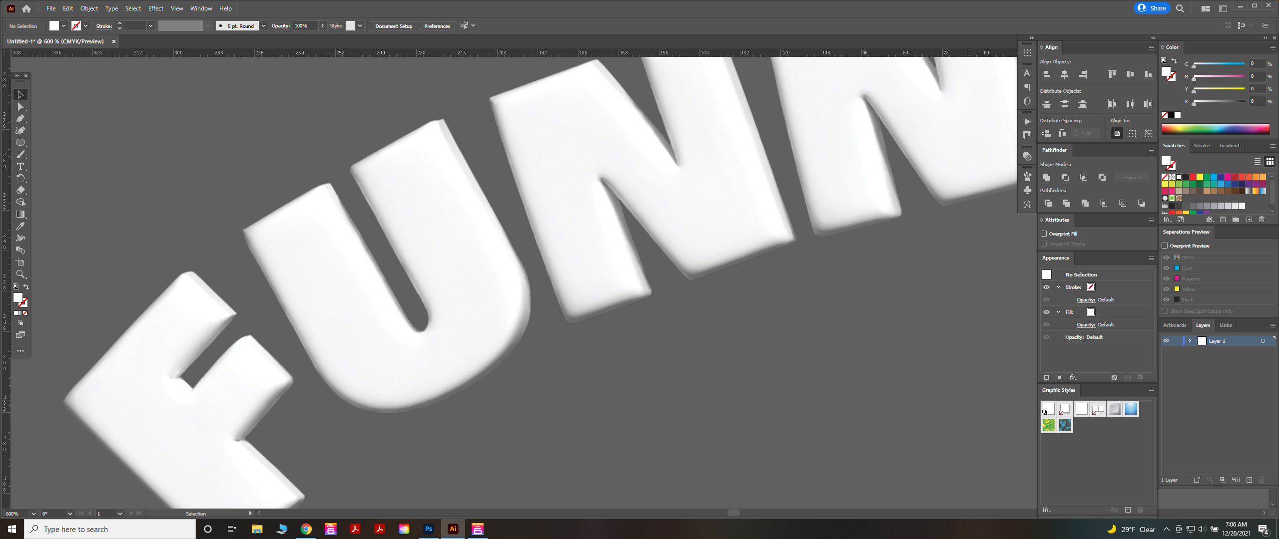

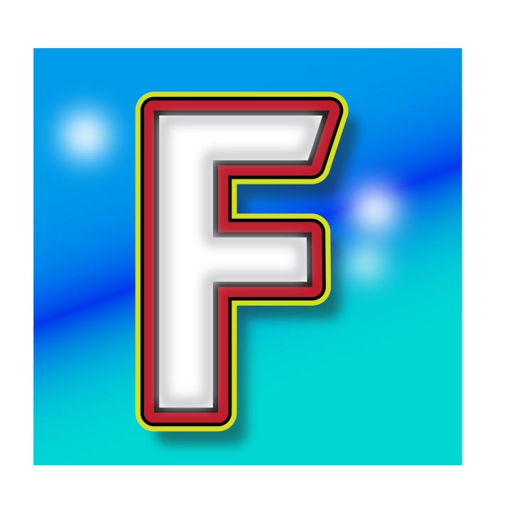

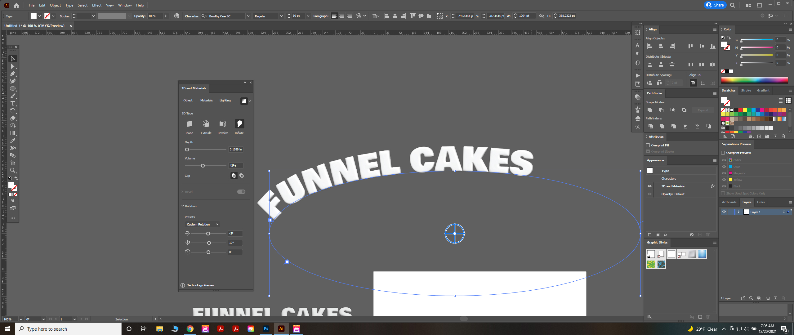

I would manipulate the text until it is on the correct curve and then do 3D > Inflate. Did a quick test to show what I did to get pretty close.
Note: font text is not correct.
