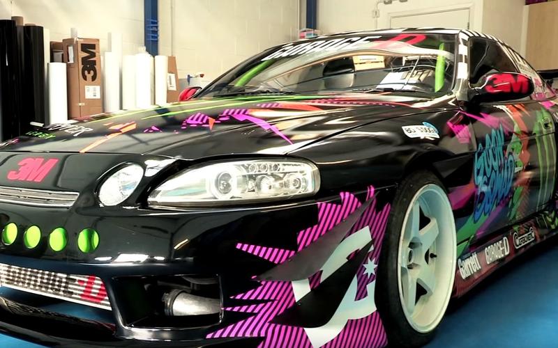

We print on a Mutoh 1324 and have for some time now. I have been watching videos online and have been looking at a lot of the vibrant colors these people are getting from printers. Some say latex and some say solvent but no names area really ever given. I am looking into what printer or printers will give brighter greens, oranges and pinks and so on like the images i have attached. No i know i may never get this but something is printing them bc they are being done lol.. These are not overlays but they are actual digital printed wraps.
Correct Color
Profiled correctly, and in a proper color workflow, any of the printers you've mentioned are capable of printing the graphics in the images you posted. None of those colors are out of gamut for any latex or eco-solvent machine.
With poor profiles and a bad color workflow, however, none of them are.
(Only exception in your question would be specifically oranges. If you want to get colors such as Home Depot Orange or KTM Orange or Pantone 021, you have to have a machine with orange in the inkset.)
altereddezignz
Thank you for your reply. All of our equipment was purchased used and it had set for a very long time. So if you have seen any of my other posts you can see that i had to pretty much rebuild the mutoh we have now. All the profiles we have are from manufactures of the material or from Value jet them selves or from other shops that use the mutoh. I think we still have underlying head issues that cause me issues as well. This is the reason we are looking at new machines.
