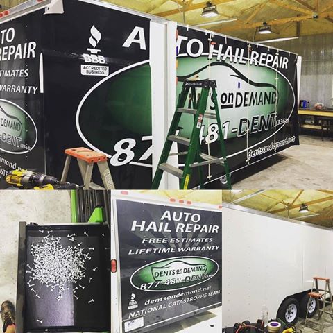

Maybe this picture will help. Sorry its the only one i have and it is like 4 images lol
