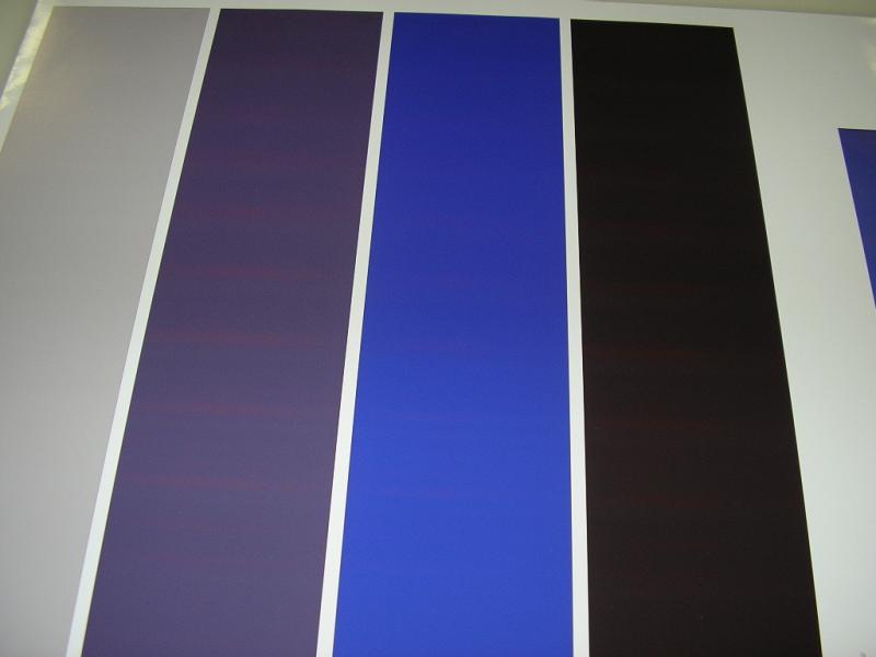

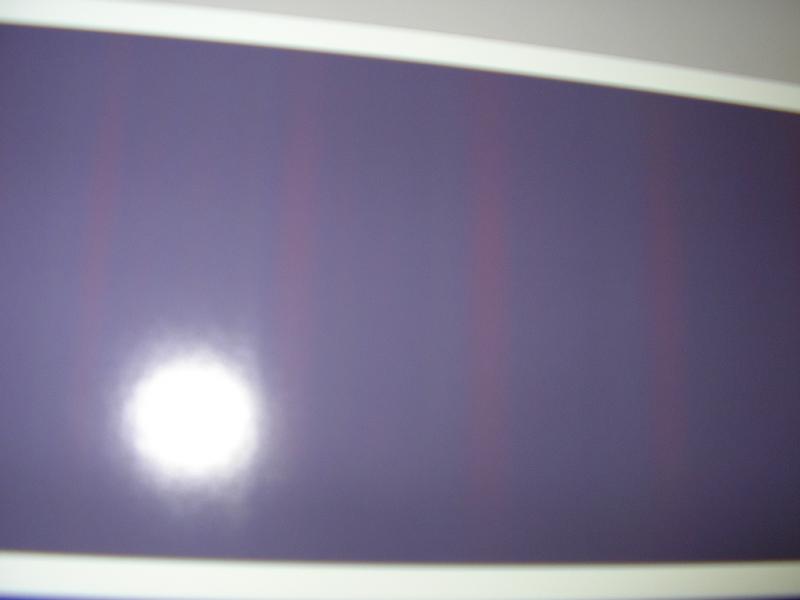

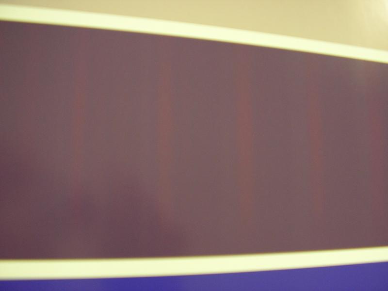

I'm having a problem with my Roland SP 540V, whenever i print on glossy media i get horrible vertical banding as seen in the pics. when i change to uni-directional mode it dissapears completely.
So far I have had a tech out twice (machine is still under warranty) and both times the problem has disappeared and come back a few days later. last time the tech was out, he replaced the optic eye that reads the encoder strip.
I'm going to call the tech out again but i wanted to have some ideas as to what might be causing this so I can make sure he checks them. Heaters are set to 40 and 41 but this problem seems to happen regardless of heater settings.
Thanks

I have to assume that it does this on matte material also, but doesn't really show as much. If not, and it's always and only gloss, I would think it has something to do with the feed. I don't run a Roland, but however you adjust feed for different materials may be part of it.
CanuckSigns
Would the feed adjustment cause vertical banding though?
HaroldDesign
Oops - missed that point. I was starting with simple ideas, and it sounds more like ink starvation or bad lateral carriage movement. I don't know!
SSG_SIGNS
That isn't where the rollers sit on the material is it? My JV3 rollers sometimes will leave a mark if the vinyl sits in the machine for too long without movement
paul luszcz
Most Roland owners are familiar with this. It's called the lawnmower effect and can be minimized in a number of ways.
The first is to calibrate the bidirectional feed. It's on the printer menu and will run a test print with dozens of bars. You match the best pair for each print head/color. This doesn't really vary by media, but is exaggerated by gloss media.
To minimize this effect after calibrating, when using gloss media, run the print at higher resolution. This will decrease the size of the print path from 1/4" to 1/8". The effect is less noticeable at this resolution.

Also try cleaning the encoder strip with an alcohol pad. I used to have a bunch of various banding issues with my SP540V, and that seemed to keep some of them in check. If the strip is dusty or a little dirty, the optical eye will misinterpret it which can cause banding and inconsistant printing. Hope that helps.
