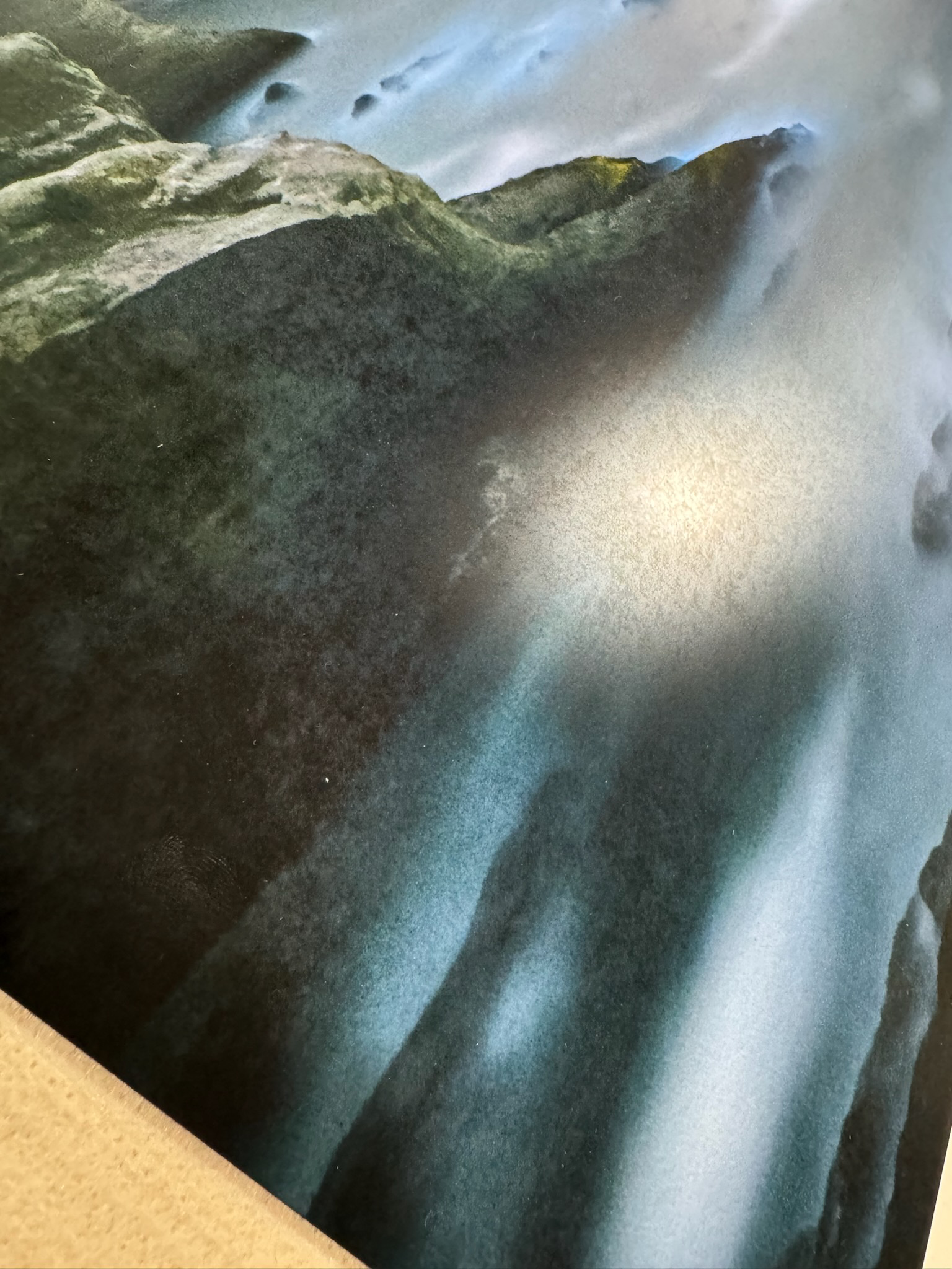

We've been printing and pressing Chromaluxe metal prints for around 12 years now, we use Epson printers with Epson ink and paper called S-Race and have a Sefa 50x100 press. For years we have had little issue with the product, but a few months ago we started to notice a large number of our prints have a residue or film left after we press them. This is happening on all Chromaluxe finishes, but more so on the satin and matte finish products. I've included a photo, hopefully it can accurately show the film/residue. Any ideas how to get rid of this? I've had someone suggest the paper is the cause but I also had someone suggest we are pressing the metal too long, we go for about 4-5 minutes for a 30x40 ish print at 45 lbs of pressure and 375 degrees. The lower temp and pressure has worked well for us, we normally don't have any edge issues, chipping, etc. but are open for other settings if it solves this issue!

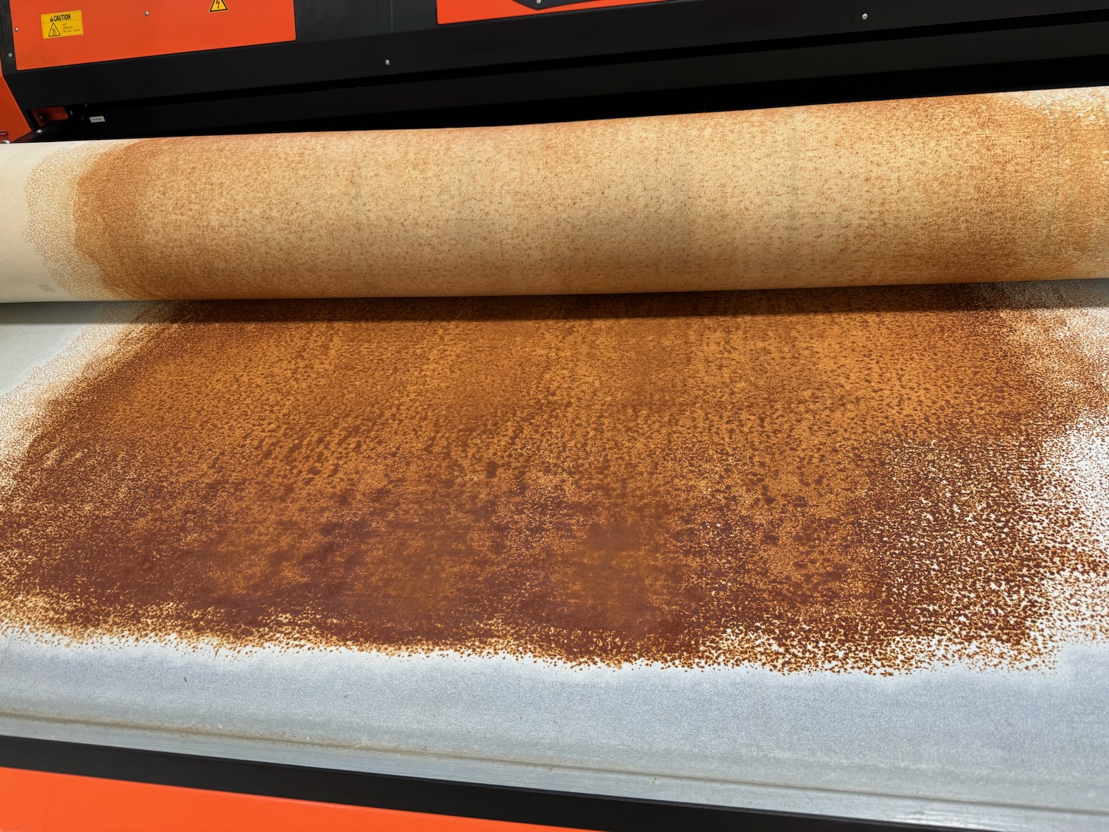

Our next issue, while investigating the residue/film today, I found we have moisture and rust on our press (see the photo below - the Nomax pad we use and the rust below it). I have already found a company who can remove the rust from the shuttle pan, but any ideas how we can avoid getting moisture in the Nomex pads and trapped under the pad between the pad and the shuttle pan?

I have had similar problems. Appears sometimes due to residue from the protective film. I suggest test a section Goo be Gone. to be sure all residue is removed. We use some standard metal but mostly press Duraluxe metal. Temp is 380 and time is 140 seconds. We always use a protective paper over and under and press face down. Also, we constructed a custom steel lower platten and have the heat from above. Using about the same pressure.

Great, thanks for you suggestion, I will test this today.

just wanted to update for anyone who finds this and has the same issue, the cleaning of hte surface before pressing did not solve my problem. I will keep testing things, when I solve it I will post it so others may be able to use the information.

Hello, we are also a ChromaLuxe certified Plus lab in Europe. I ever experienced such issue. We always remove the moisture when we start sublimating (we heat the res, then press without plates multiples times, until there is no more moisture/condensation below the felt of the bottom plate (just put your hands under the felt and check the moisture.

Try another paper.
Switch pads throughout the day.
Use buffer paper to absorb extra mosture
Are you seeing steam come off prints?
Controlled printing & storage environment?
The rust is a problem. Switch to an aluminum plate or stainless.
