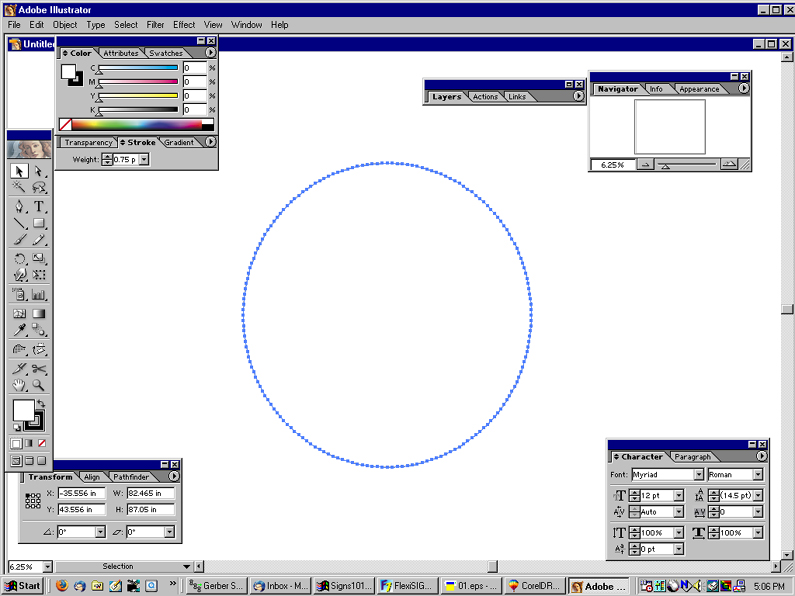

I've downloaded the DR Stika software and installed it. It does not provide for exporting into any universal vector format. What it does do is allow you to copy it to the clipboard.
Once on the clipboard, I was able to paste it into Adobe Illustrator as well as into FlexiSign. CorelDraw 8, however, allowed the paste but the result was unusable.
That's the good news. The bad news is that the file comes out as linear data .... which is to say all straight lines. No arcs and no curves. This, of course, makes for really bad looking cut vinyl as you enlarge from the original size.
Best option, IMHO, would be to contact Roland to see if there are any acceptable alternatives to this.
This is a circle made in Dr Stika and pasted into Illustrator showing the nodes.
