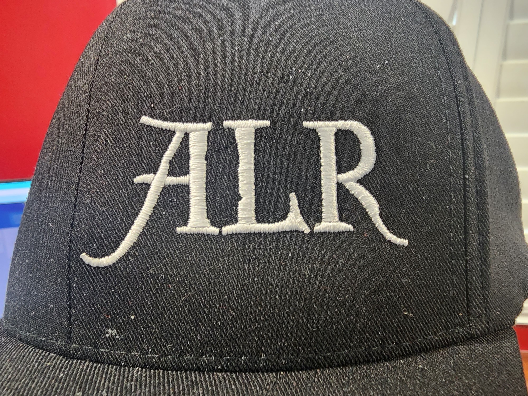

Thanks. I don't know why they used a font like that for embroidery but whatever...

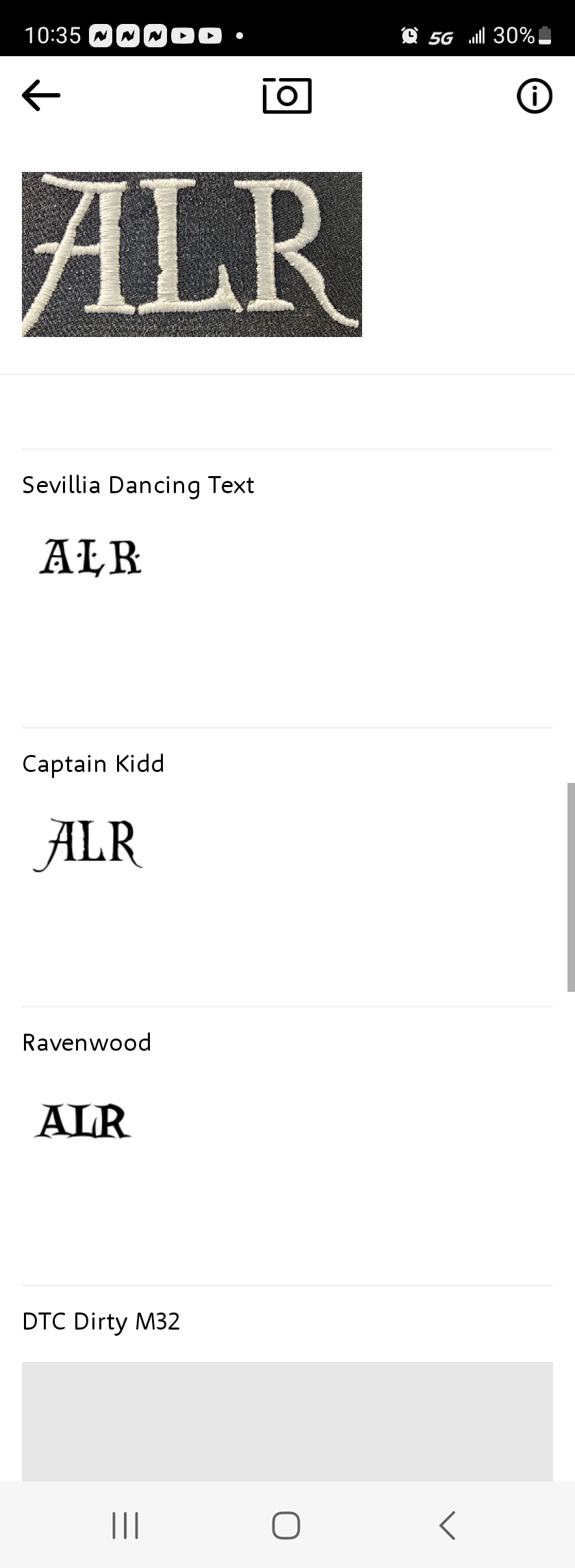

I used whathefont app to tell me. Now in ur software if u have ttf stitch conversion then ur home free. What software u use?

I manually draw them from the image. I was looking for the font because the pic of the hat is not flat or straight on.
