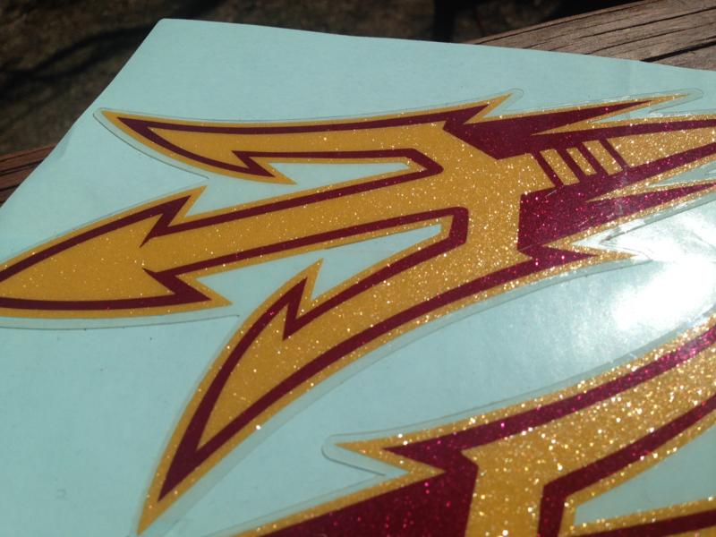

Hello,
Taking a guess here.
1) The print on the glitter material.
2) they die cut the glitter material.
3) They weed the glitter material.
4) They mount the glitter material to convex or substance or 3m clear for football helmet decals.
5) They laminate over it with convex clear.
6) They kiss cut.
Sounds like it can be tough to align the glitter on the convex so it will match the die line. Any other ideas or anyone with a proven process on how to make these?
or did I miss something and there is glitter foils I can use with the edge fx?
