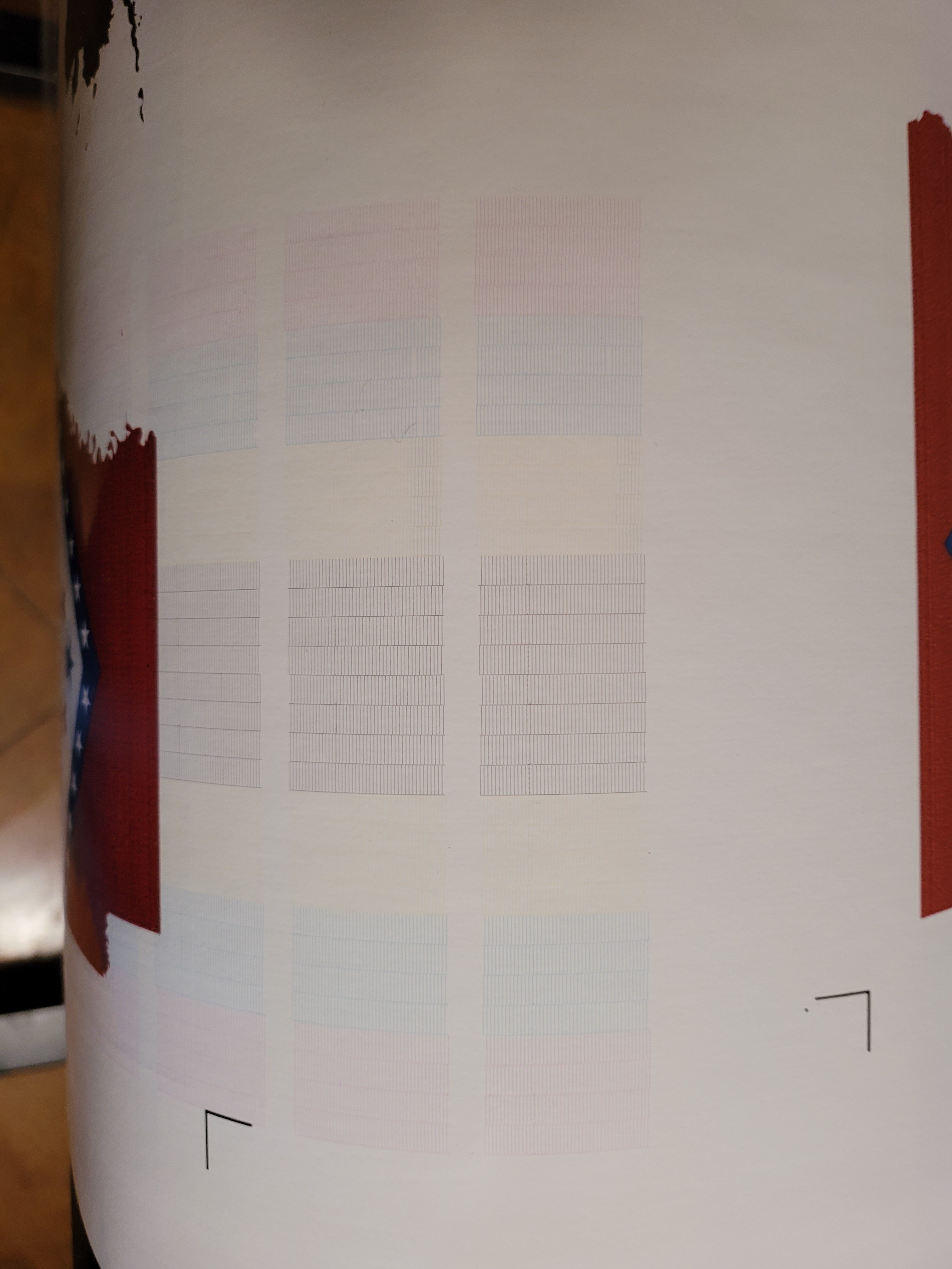

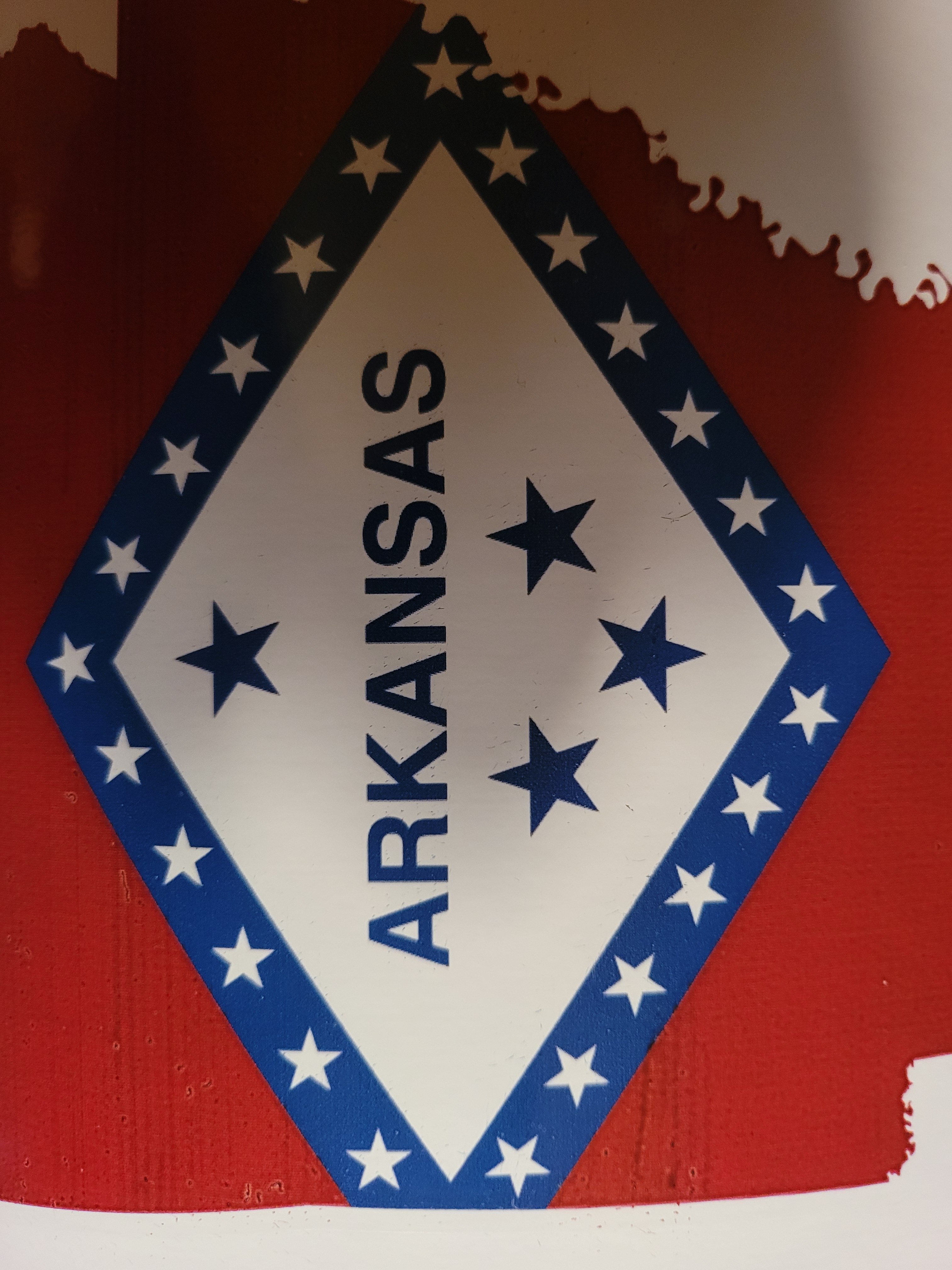

Kind of new to my Mimaki and I am having trouble with printing . See attached print out and nozzle check. Any help is appreciated. I tried hard and soft cleaning but no change.

The only bad thing I can see on those pictures it is black inks on yellow on the nozzle test. Try to soak the head in cleaning liquid for 1-2 hours, if it wont help then replqce the caqp and pump, and then if it will still be a problem you'll have to replace the printhead. If the current head is older than 4 years there is no doubts - printhead needs to be replaced
