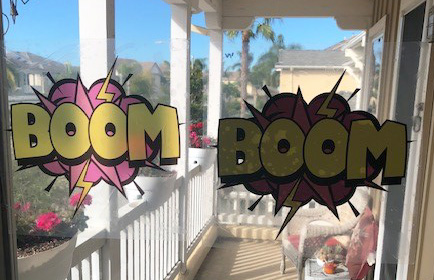

A printer with white ink would be able to put a white under base beneath the colored inks, to provide a platform to improve the optical density of the colored inks. The attached image shows the same image printed without and with a white under base on a clear SAV film.
