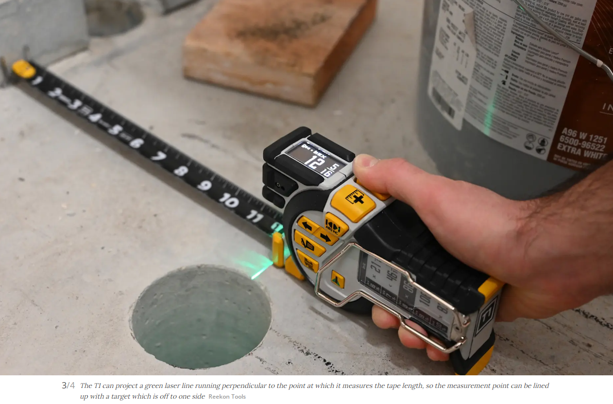

I prefer to take my pictures with a camera - I can't get the pictures off my tape measure. I have been to four camera stores and they all lookat me like I'm crazy, LOL.
You need to get better gear
This one will broadcast to the cloud or directly to your phone in 4k 120fps....
