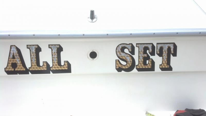

Name worked out good for my first attempt thanks to everyone's help. Put on my boat last night, now if the sun will come out so I can decide if I like the silver leaf......
