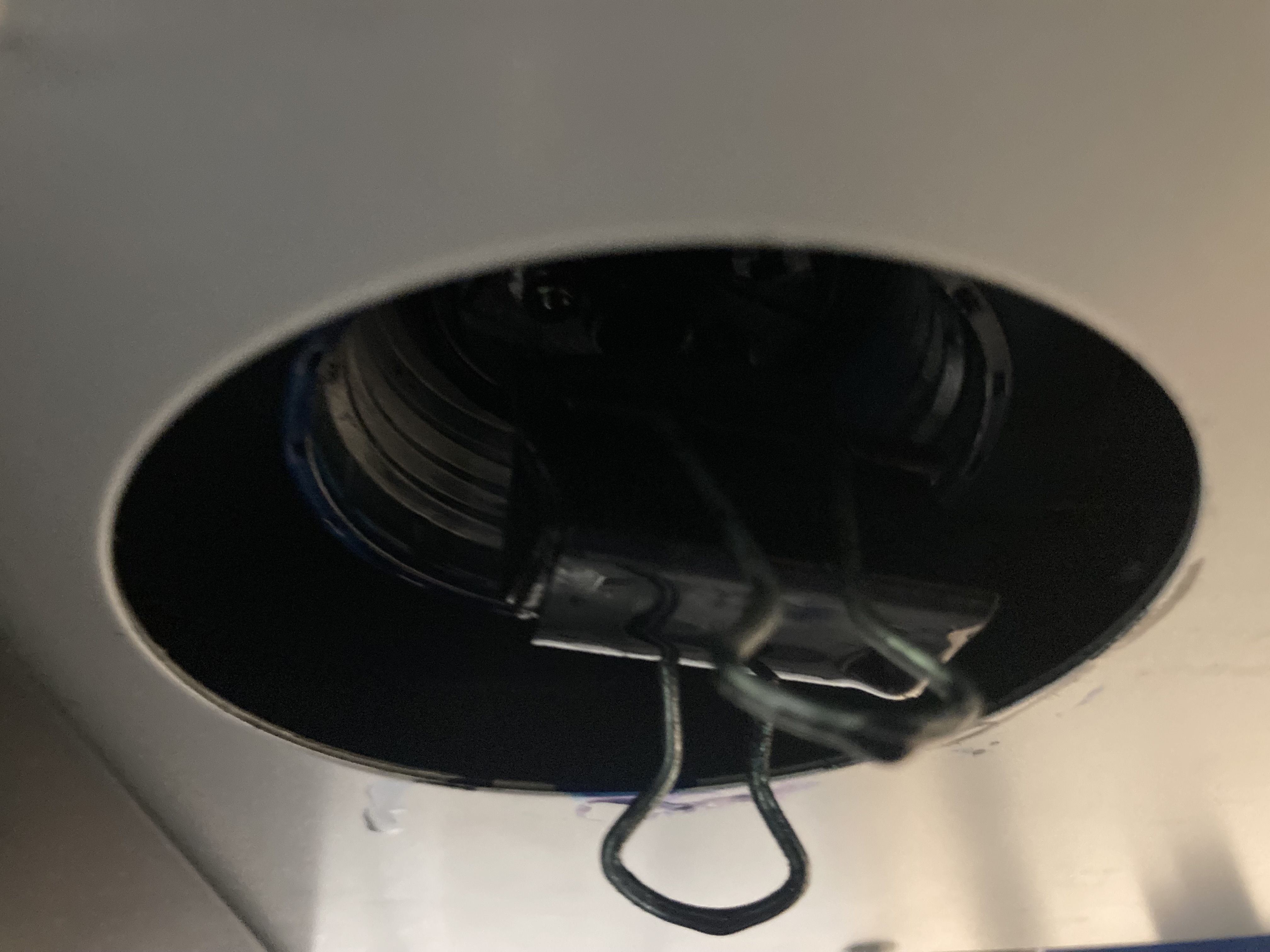

Hi Folks. An old friend gave me a call that her school has a plotter that doesn't print. I went to look at it and did several powerful cleanings as well as manual cleanings. Every time I do a test print nothing is coming through, absolutely nothing not even a mark. I opened the waste bottle and it has a bulldog clip on it, she believes it was leaking and that is why it was tied off. Unscrewed the hoses and the ink has not dried up in the lines. But I can't get it to print anything at all.
The machine has been unplugged for over a year. As a school they have no money, I gave the vendor a call but they are no longer in business. Any ideas where I should start? I appreciate any help. Thank you.
