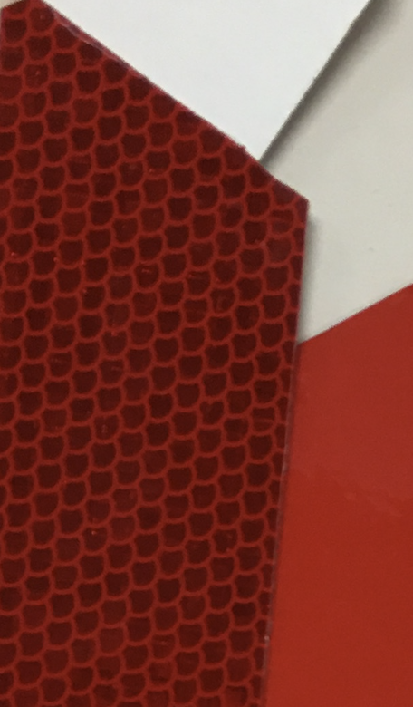

Do any Canadians here have a source for this high vix red stock? We are working on something and have a reflective red vinyl, but client wants material like in the image attached. We are located in Ontario. ND does not carry the red.
Reach out to wri - they stock all of these I believe. What you'd want is 3m 3932.... The above looks like Avery, but 3m looks pretty close.
Google then3m version though, it has lines through it and looks slightly different.
That could be diamond grade... 3m 4092 - it's pure red without the stripes. There's not much use for it, so most places don't stock it and just print the red.

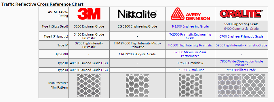

Do you need the exact same brand? I'm having trouble identifying it. The lines look most similar to Oralite or Nikkalite. But neither of those are perfect matches.
Unless that's a vehicle conspicuity tape and not a traffic sign reflective?

It would not need to be the exact same thing, just close. We priced and showed them a sample on a red reflective we had in stock and it was not what they were looking for. They sent back a picture of the material they got from a previous supplier. Looks kind of like the Oralite pattern.
It is for slow moving hazard labels that go on farm equipment.
