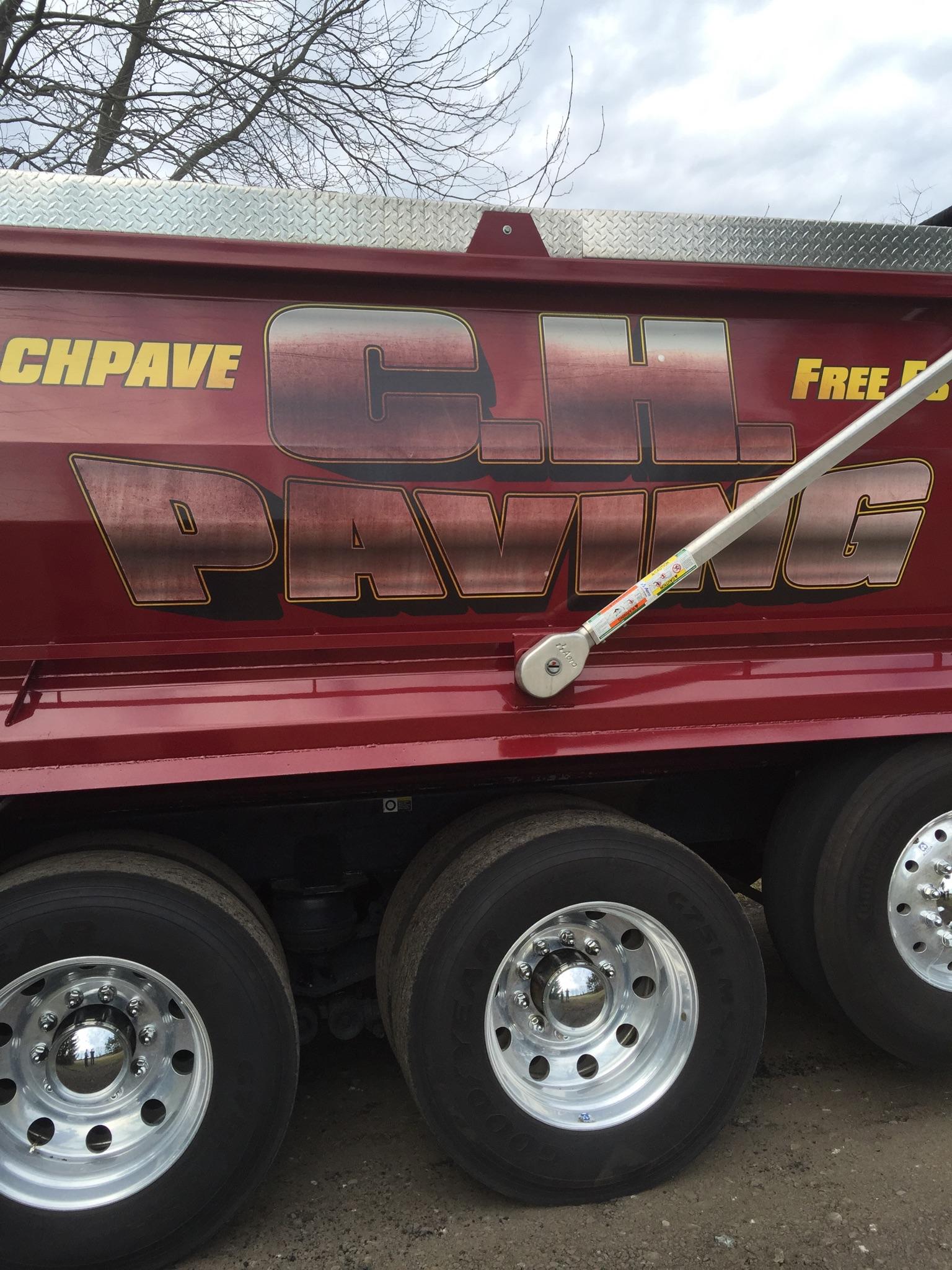

customer has a paving company that we letter the trucks, specifically the bed of the dump trucks. they get extremely hot from the asphalt so over time it burns the vinyl lettering. first time i did it with orajet 3751 and that lasted like 3 or 4 years. second go around i used orajet 3951HT,it was recommended by orafol because they were testing it on there heating and ac units on roof tops with good results. first truck lasted 2 years before it started burning and now the last truck didn't even go a year. one of the added issues is the crap metal they are using anymore. wondering if anyone has used a product in this or a similar situation with better results?
Is there a way to attach a separate panel by welding or whatever to prevent the heat from penetrating through ??

There was a guy on here long ago who had the same problem with hot asphalt trucks turning vinyl dark. Run a search on here.
Boudica
This one?
Reactions: 1 users
Johnny Best
Yep, thats it Boudica, great find. Two great signmen, TimToad and Derby City are in there.
What would happen if you double laid vinyl on the metal, that would give it more life.
petepaz
gino thx for the idea i will see what we can do on that. boudica thx as well funning thing the truck in that pic is one of my customer's competitors.
i think i will try the easiest option first and try to redesign the graphics so they only go across the upper area of the bed. that seems to hold up the longest. that will give me some more time to get some more info and find the best option
thanks to all as usual
